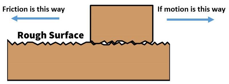

rudransh verma said:
But the direction of friction is horizontal.
Not horizontal, but parallel to the surface.

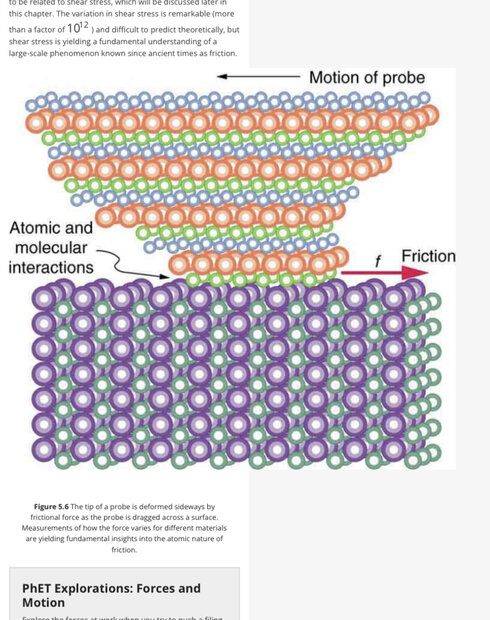

I don’t get how friction occurs.
Below you have an image showing what two surfaces in contact with each other look like on a microscopic level. The small peaks are constantly broken as the parts move, thus the friction force. The rougher they are, the higher the friction force.

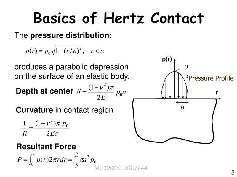

Pneumatic Tires
If you follow car racing, you'll notice that racers tend to use very wide tires to increase the grip - in other words, friction. The only goal for that change is to increase the tire-road contact patch area.
But the theory says friction doesn't depend on the area. Theoretically, they could use tiny bicycle tires and they should have the same grip as very large tires. What's happening?
Tire rubber has a special characteristic: Its coefficient of friction decreases rather dramatically when it is more compressed.
The problem is that the normal force is never distributed equally on a tire-road contact patch. When we divide the normal force by the contact patch area, we obtain the average pressure. But the reality is that the pressure at the center of the area is greater than the pressure on the edge of the area. The following figure shows the pressure profile acting on a tire-road contact patch:
But the wider the tire, the more the pressure distribution is equalized (i.e. the shape of the curve looks more like a rectangle, meaning the pressure acting anywhere is very close to the average pressure). With a small contact patch, it can be shown that the increase of the tire friction coefficient times the smaller forces acting on the edges does not compensate for the decrease of the tire friction coefficient with the high force acting at the center.
In such a case, the area does influence the friction force.

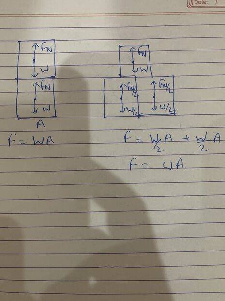

jack action said:
Say you have a weightless block with a surface area A and a weight W sitting on it. Let us assume the coefficient of friction is 1.0 and that the friction force is proportional to the weight and area. Thus the friction force is WA.
Let's put the same weight W on two of those blocks A, sitting side-by-side. Now the normal force on each block is W2 leading to a friction force W2A for each block. Since you have two blocks, the total friction force is W2A+W2A=WA. So even if we double the area by putting an extra block, we also are halving the forces acting on these blocks. You can put 100 blocks, you will still divide the weight W by 100 on each of these blocks, still leaving us with a total force of WA.
So what does it mean? Well, the friction force is not proportional to the weight, but rather to the pressure applied. Thus Fs,max=μsPNA. But since PN=FNA, the equation simplifies to Fs,max=μsFN, completely ignoring the area.
This is the free body diagram I think. For one block or two, the friction is same WA.
But what you want to say is friction doesn’t depend on Area but rather to the pressure applied. We are changing Area and still getting the same Force WA. Pls make it clear!
No, what I'm saying is that IF you want to consider the area, you must also consider the pressure, not the normal force. Looking at it this way has the advantage to agree with our intuitive notion that a greater area gives a greater friction force.
