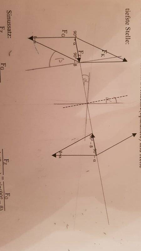

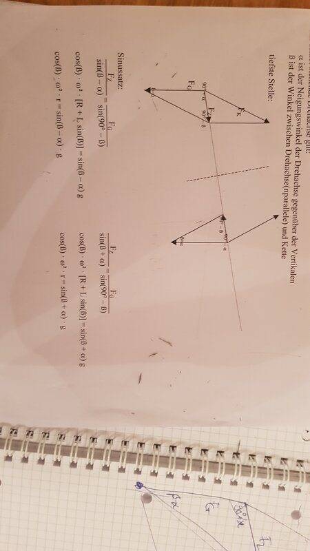

Hi guys,
Currently, we are discussing the physics of wave swing with and without the constant changing of the rotating axis. Former situation gives me problems. Our teacher presented a solution (attached), in which he explained the relationship of the actual tilt between the rotating axis and the chains (beta) and the tilt between rotating axis and the vertical axis (alpha). He makes use of the law of sine ("Sinussatz" in German).
I do understand the explanations with one exception: How can we assume, that beta is the same at the lowest and highest point of the ride? To go one step further, does that mean, that beta is constant at a given alpha for all "positions" on the described circle at that moment? I hope you know what I mean, it's hard to express :)...
Edit: I now included another "commented" pic, maybe it now is easier to understand...
No equations needed, I guess...
Yeah, as I said, i have no idea why we can assume beta to be the same for any position at given alpha.

There would not be a unique behaviour. Consider the much simpler case of a pendulum attached at a fixed point but, instead of simply swinging back and forth in a vertical plane, able to move around in x and y. In general, it can perform complicated motions: .
So we need to think what the simplest behaviour might be. An obvious problem with the teacher's solution is that the passengers are experiencing changes in GPE as they rotate about the tilted axis. This will likely lead to greater speed at the lowest point, so a greater angle to the axis.

Alright, so apparently beta is different for any position on the circle at given alpha. Could someone give me an explanation as to why?

No, sorry, I don't understand. I do understand This is true for alpha changing constantly, as the two equation I attached suggest that beta is dependent on alpha, thus beta changes with changing alpha. HOWEVER, I considered a 'stopped' moment with alpha being given. Apparently, beta is still different for every position on the trajectory. This is what I do not understand.
I think, I made a mistake by saying that the teacher suggested those two equations for the system as a whole. This was a mistake on my side, those equations represent the wave swing in a 'stopped' moment, like freezing time.

I've just thought of a simple demonstration that beta will not be constant.
Imagine a very slow rotation. The seats will just hang vertically. β varies between -α and +α.

Yes, I do understand that when alpha is changing beta is changing. But again, after asking my teacher it turns out, that every position on the 'stopped' wave swing's trajectory has different beta from another. This is what I can't get my head around.

If I understand the original problem correctly, you have a central axis leaning at some angle α to the vertical. In reality this can vary, but let's keep it fixed, and in a fixed direction: say it leans to the north always.
Rotating around this axis at a constant rate ω is a disc, the canopy of the ride.
Suspended at intervals around the perimeter of the canopy are cables with masses attached.
Suppose a particular cable makes angle β to the axis when at its northmost position, so makes angle β-α to the vertical. What angle do we expect that cable to be at when in its southmost position? Will it still be at angle β to the axis (so β+α to the vertical) or still at β-α to the vertical, or something else?
In an attempt to analyse it I simplified by shrinking the canopy to a point and requiring that the plane containing the axis and the cable rotates at ω, but I still have not found the equation.
So instead I went back to the problem as I described it above and considered the case of small ω. There is little centrifugal effect, so gravity dominates and the cable should remain nearly vertical.
At the other extreme, large ω, the centrifuge dominates and β will be nearly constant.
In the ride in the video, the cables look to be about 50 degrees to the vertical when α is zero, implying the centrifugal acceleration is more than g, but not much more.
Likes Delta2
Yet another simplification option:
In reality, the behaviour at any point in the cycle depends on the history. E.g. in going from the high (south) position to the low position the rider will gain speed, so swing out further. But suppose we treat the north and south positions, independently, as snapshots in a motion in which the seat is describing circles around the axis, normal to it.
If the canopy has radius r and the cable has length L then the radius of the circle is ##r+L\sin(\beta)##. The centripetal acceleration is ##\omega^2(r+L\sin(\beta))##, and the component of this normal to the cable is ##\omega^2(r+L\sin(\beta))\cos(\beta)##.
The tension has no component in that direction, so this must equal the component of g in that direction, ##g\sin(\alpha+\beta)##:
##\omega^2(r+L\sin(\beta))\cos(\beta)=g\sin(\alpha+\beta)##.
The same calculation for the north position gives ##\omega^2(r+L\sin(\beta'))\cos(\beta')=g\sin(-\alpha+\beta')##.
Clearly, β and β' are different unless α=0.
Relating this to the two extremes I described earlier, as ω→0, β+α and β'-α tend to 0 (i.e. hangs vertically) and as ω→∞, β→π/2, β'→π/2.
