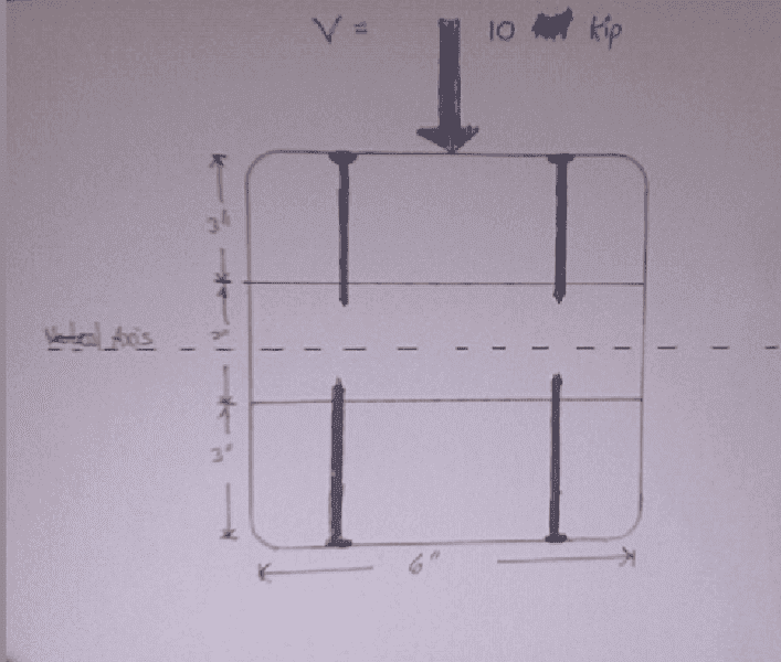

We are doing shear flow problems and my instructor has been unable to explain the topic in a general enough way to apply effectively to all problems. Our (my class) difficulty is understanding in the formula q=QV/I where the variable Q=yA' what to use for A'.
It seems to vary so drastically from problem to problem that there is no set way to find it.
Will someone please explain to me what to use for A' in this problem:
The three boards are nailed together as shown. How should the nails be spaced if each nail can resist 100 lbs?
I was thinking of using [tex]q=\frac{F}{spacing}=\frac{QV}{I}[/tex] and only using the area of the top board. This would get me the spacing if there were only two nails. Then I could multiply that number by two to get it for four nails since it is symmetrical about the neutral axis.
Does this sound right?

Anyway, the value for A', for calcualting shear in the upper nails,is the area of the top board. Similarly, for calculating shear in the bottom nails, you have to use A' for the bottom board. You can't just spread the load amongst both sets, you've got to look at each pair separately (they each see the same shear flow because of symmetery). Otherwise, your approach seems OK. Check your value for V or the allowable nail force...one or the other seems too high or low.

What is tricky is finding out which Q to use. It is different on a case by case basis. I think that my assumption, though, was correct. To analyze the shear flow in each nail, I could use the top board (it is three boards nailed together by the way) and find the shear flow in two nails and then divide that number by two (since the beam is symetrical).

I think you may have it right, but unless you show some numbers, I can't be sure. When you calculate the shear flow for at the joint between the top and middle board, you must divide that flow by 2 to get the shear in each nail at the top. To get the shear in each nail at the bottom, you calculate the shear flow at the joint between the bottom and middle board, and divide that flow by 2. Is this what you are saying? But when i run your numbers, i get a very impractical small nail spacing along the length of the member in order to keep the nail shear force to 100 pounds per nail; that's why I asked you to check your input values.

Yes. That is. Sweet!

Great. Be sure to start a new thread when you post another problem. BTW, when you divide the shear flow by 2, you get the shear flow per nail in kips per inch, q_n, then you find the nail spacing along the member length using s = F/q_n, as you had previously noted. I just wanted to clarify that.
