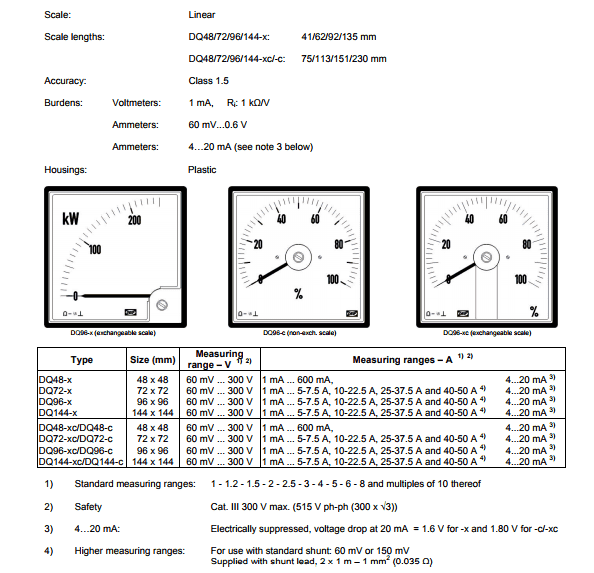

Here is a datasheet od Deif instruments, on page 4. I have DC instruments and there is measuring range from 1mA-50A, there is no 150A. So, how my instrument will show on scale 150A, if measuring range is up to 50A.

  • Datasheet table of panel meter specifications: scale types, accuracy class 1.5, burdens, and housings, with three meter face diagrams (DQ96-c kW, DQ96 and DQ96-xc percent scales) and a list of measuring ranges for DQ48, DQ72, DQ96 and DQ144 models.

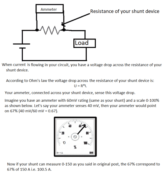

What I think is confusing for you is that the ammeter reads a voltage drop across the shunt, which is proportional to the current through the shunt, which is seen from Ohm's law.
Look at the circuit below, the resistance is your shunt device.
Circuit schematic of a shunt ammeter: a battery feeds a resistor labelled as the shunt device, with an ammeter connected across it and a load in parallel, followed by a meter dial showing a needle at about 67 percent of scale.
6da22b0a8e1f438079b4855b08e19ec3
If you have a ammeter with a scale of 0-50 A, but your shunt can measure 0-150 A then do as described in post #6, but make sure the mV rating is the same for your ammeter and shunt (60 mV).

But, my problem is that I don't know what measuring range means (attached datasheet or picture in post #7). There is 1mA-50A, it's probably not scale, because scale is changable?
Aha, I think that the measuring ranges from datasheet in post #7 is the range the display can measure without having to use an external shunt. If you wish to go above, you need an external shunt.

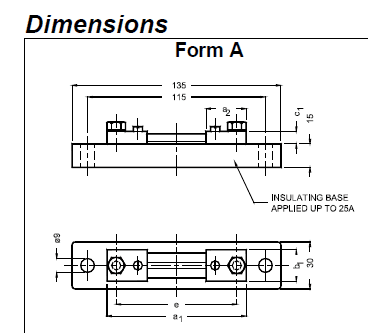

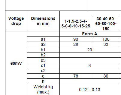

c'mon guys, this isn't an electrical problem it's a catalog reading problem.
You know how an ammeter with a shunt works.
So you need a shunt that measures 150 amps. Looks like those come in two flavors - 60 mv and 150 mv. SO you need a meter that shows full scale at whichever millivolts you pick for your shunt.
60 mv looks like a good choice
Dimensions drawing titled Form A of an insulating-base shunt, top view with width labels 135 and 115 and height 15, plus a bottom view with dimensions 30, 9 and 4 marked, noting insulating base applied up to 25A.
Catalog table for panel meters with 60mV voltage drop, listing dimensions in mm for Form A models: a1 90 or 100, a2 28 or 33, b1 20, c1 8, e 78 or 80, weight 0.12 to 0.13 kg.

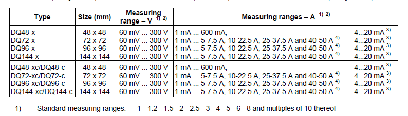

Table of panel meter types from a catalog, listing DQ48 to DQ144 models with sizes and measuring ranges in V and A, and footnotes on standard ranges.

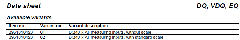

if you want the smallest size meter i'd guess it's the second one
Data sheet table of available variants for DQ, VDQ, EQ. Item no. 2961010420, variant 01: DQ48-x All measuring inputs, without scale. Variant 02: DQ48-x All measuring inputs, with standard scale.
bigger sizes are further down the table.

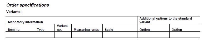

figure out how to specify 60mv/1ma sensitivity and scale "0 - 150 Amps"
Order specifications form with a Variants table. Columns: Mandatory information (Item no., Type, Variant no., Measuring range, Scale) and Additional options to the standard variant (two Option columns). Table has one empty data row.
1 ma input(measuring range) and specify scale --- 150 DC amps ?

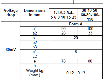

Observe note 4 on the catalog page - you'll want to mount it within one meter of the shunt or else order special longer leads...

  • Catalog table for a panel meter with columns for voltage drop, dimensions in mm, and form sizes 1-1.5-2.5-4-5-6-8-10-15-25 and 30-40-50-60-80-100-150; the 60mV row lists a1 90/100, a2 28/33, b1 20, c1 8, e 78/80, and weight 0.12 to 0.13 kg.

  • Table of panel meter types (DQ48-x, DQ72-x, DQ96-x, DQ144-x and their -xc/-c variants) listing sizes, measuring ranges in V and A, and 4...20 mA output options.
