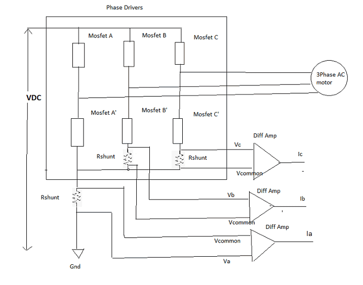

I have seen an application note of how to measure the phase currents using shunt resistors as shown below
I am only confused with the connection when measuring the phase Ia current, it differs from the way the shunt resistor is connected for Ic and Ib, he could have done the same way like Ib and Ic. Is there any advantage doing like this? By using Ia he was also able to detect the fault in the phase currents? My question is what are the conditions under which the phase currents can be wrong like one condition i can think of is
a. Ia+Ib+Ic ##\neq ## 0.
The asymmetric wiring does seem very deliberate.

The current sum is part of a hardware over-current detector.
The current sum can also be read by software.
Channels 2 or 3 current can be read with software.
Channel 1 current can be computed from Isum - I1 - I2.

Thank you. I am confused about the channel notations, but i assume that Channel 1 -> I3, Channel 2 -> I1,
Channel3 -> I2. The hardware notation followed for measurement of current is different, since they want to incorporate all the three phase currents to detect the over current fault is my understanding.
This is based on the system, in this it corresponds to the voltage of ##3.3*30/31.5= 3.14V ##. Hence the ##I_{sum} - I_1 - I_2 =I_3## one of the phase currents exceeds this value then it detects the over-current?
Sorry for the earlier typo;
Notice that the outputs from the differential current sense amplifiers are referenced to Vref, which is half of the AVDD voltage = 3.3V / 2 = 1.65 volt.
