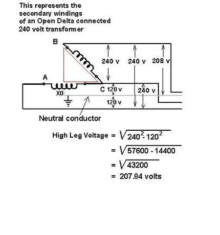

Tom. For complete information of my power system. I found out my transformers power configuration is a 3 phase HIGH LEG delta (High leg open delta?) with one of the 3 phases to neutral measuring 208 volts instead of 120 volts... (this open delta composed of 2 transformers connected to only 2 primary source as detailed earlier).
Diagram of an open delta transformer secondary with a high leg: winding B is drawn at the top, A and C at the bottom, with a neutral conductor below; voltages labelled 240 v, 240 v, 208 v, 120 v, 120 v, 240 v, and a high leg voltage calculation giving 207.84 volts.
I learned this after I let my electrician measured each of the phase to neutral voltage in my main panel yesterday:

X1 to neutral is measured as approx. 210 volts (or 208 Volts).
X2 to neutral is measured as 120 volts.
X3 to neutral is measured as 120 volts.
But between X1-X2, X1-X3, X2-X3.. they are all 240 volts.
Now my admin breaker (in middle) is connected to the X1 and X2 producing split phase and hence the same as your US split phase 120/240Volts (my power system in my building is indeed more complicated than your US single phase home supply)
My question is, the X1, X2, X3 configuration in the transformers are permanent right? Or would there be unexpected rotations making X2 to neutral 208 volts instead of X1 to neutral. This is important because if the SPD supplier puts150Vac between my X2 to neutral and suddenly it becomes the hot 208V from transfomers, then the MOV thermal fuse would initiate thermal breakaway (or destroying the SPD in the process).
If there is no rotations. Our discussions were still valid even though X1 to neutral is 210 volts because it's high leg delta?

Diagram of an open delta secondary transformer winding with points A, B and C, labelled 240 v, 240 v and 208 v between line pairs, 120 v to neutral, and a neutral conductor; below it, high leg voltage = square root of (240^2 - 120^2) = square root of 43200 = 207.84 volts.
As long as the "A" and "C" connections are on the transformer winding that has "X0" there will not be a problem with a phase sequence change.
Any change to cause different voltages on the wires would have to be physical, secondary side, wire changes to the transformers on the power pole.
I am curious though, if I recall correctly one of your earlier posts said their was 3 wires coming from the power pole to the service entrance. Which is OK. The question is: In the photo of the breakers, where do those 4 wires go that are on the Neutral? Equivalently, how is the Neutral derived locally since it is not brought in from the power pole

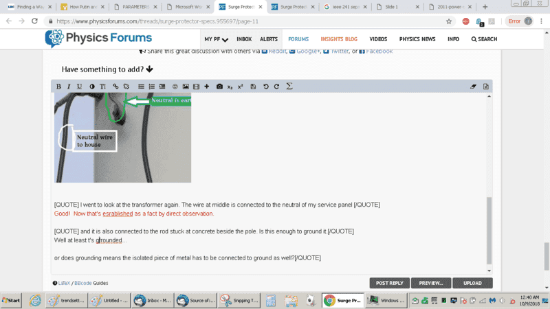

The 4 wires in the neutral bar connects to all the neutral in the building as well as the centertap of the 3 phase transfomers (Yes I individually traced where the 4 wires lead... they led to all the neutral subbar in the subpanels and outside to the service entrance 4 wire entrance). I paid the utility company $4000 for the 2 transformers that is why they tap their centertap to my panels. But for my own home.. no wire from centertap.. btw.. this office building is owned by many co-owners. I'm just one of them and in charge of administration.

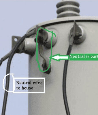

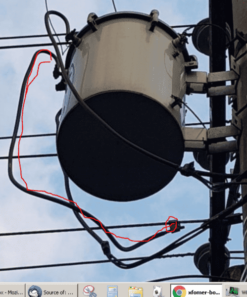

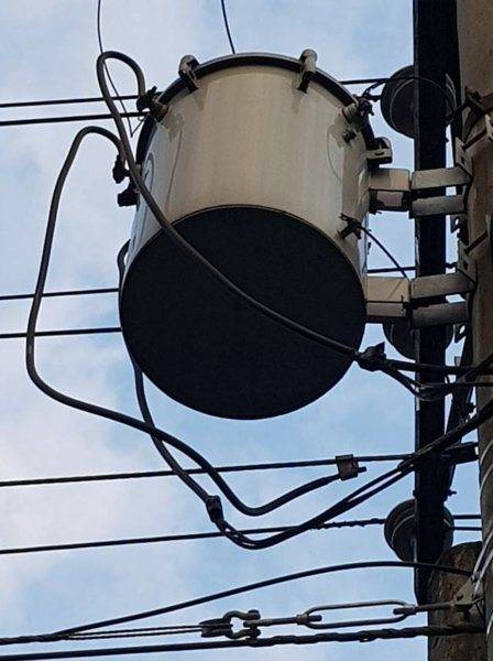

Photo of a utility pole transformer with four wires running to it, the wires labelled 1 to 4 in red numerals.
My service entrance is really 4 wire (not 3 as I mentioned earlier).. I counted them, the 4th small wire is the neural wire hopefully connected to the centertap of the transformers.. I said "hopefully" because it goes to the pole but electrical engineers in my country talked about "floating ground".. that it's not connected to the centertap but just to ground besides the pole. When I have time. I'll use my high resolution binocular to see if the wire is connected to the centertap (after trying to learn where exactly is the centertap located in the transformers).
  • Photo of a utility pole transformer with four wires running to it, the wires labelled 1 to 4 in red numerals.

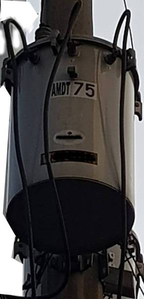

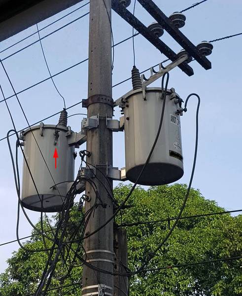

Could one argue that since X1 to neutral is measured as 208volts then the centertap was used. or can you also measure 208volts even when it's a floating ground (not actually connected to the transformers centertap)?
Also where is the location of the centertap of transformers?
Two gray pole-mounted distribution transformers on a utility pole among green foliage, with high-voltage bushings on top and cable leads hanging below; one transformer has a partially visible label reading WS and a red mark.
Should it be at the center (of 3 terminals) in the right or can it be any terminal or leads in the left picture (above the red question mark?) This is just theoretical and to know if the centertap is indeed tapped. As I explained in another thread. Our utility company is saving wires that's why most homes don't have the centertap connected with wires to the service entrance panel.
  • Two gray pole-mounted distribution transformers on a utility pole among green foliage, with high-voltage bushings on top and cable leads hanging below; one transformer has a partially visible label reading WS and a red mark.
That labmanager article you referenced has a few statements that do not reflect how the Universe operates (aka reality), which make me skeptical. However the basic premise is valid, that there are more approaches than using MOVs.
The ZeroSurge device may be appropriate for type 3 SPD usage when used with a transformer at the point-of-use whose primary is protected with a type 2 or type 3 SPD, and when one secondary terminal is Grounded.
There is not enough information available on the ZeroSurge website or on their data sheet for an in depth engineering evaluation.
I did a quick approximation of the minimum requirements for a Series Mode filter without an on-site transformer and came up with a requirement for 3 capacitors of 350μF at 400V, rated for pulse operation, and some inductors (coils). I found one capacitor that meets some, but not all, of the requirements. It is 3 inches in diameter, 9.5 inches long, and costs $85 USD. The rating it fails is the pulse voltage, and does so badly; maximum 12.5V/μS; the UL standard waveform is 750V/μS (6000V/8μs)
For the power pole transformers, I will defer to @jim hardy as he is the resident power plant guy. Jim, note that the pots have only one HV insulator each.

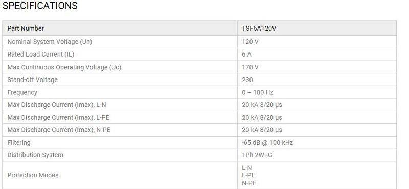

according to the site: https://www.labmanager.com/laboratory-technology/2014/05/surge-suppression#.W7ryhPZuIUC
"Plug in type suppressors will typically have a VPR of 330 volt (ideal) but will have a 127 volt MCOV (not ideal—too close to line voltage). Suppressors installed at the service panel will generally have a safer MCOV (175 volts) but a much higher VPR of 600 to 1,000 volts (also not ideal—damaging to sensitive electronics)."
Now here is Erico TSF6A120V spec sheet:
Specifications table for surge protector part TSF6A120V, listing nominal voltage 120 V, rated load current 6 A, MCOV 170 V, stand-off voltage 230, frequency 0 to 100 Hz, and 20 kA 8/20 µs discharge currents.
You see.. the Erico MCOV is 170V. earlier website said 330v belong to MCOV of 125V. So it's odd when other manufacturers can't do a 330v with MCOV of 150Vac.
Also I think it's possible many are confusing SVR and VPR value. The 330V seems to belong to SVR. With the 3000A (versus 500A test surge) of VPR, I wonder if it can really come up with 330V VPR similar to SVR. I'm still googling other genuine products with 330Vac VPR at MCOV of 150Vac.. even Leviton, Siemens, and Eaton can't do it.. so I wonder if the others can that these giants can't...
  • Specifications table for surge protector part TSF6A120V, listing nominal voltage 120 V, rated load current 6 A, MCOV 170 V, stand-off voltage 230, frequency 0 to 100 Hz, and 20 kA 8/20 µs discharge currents.

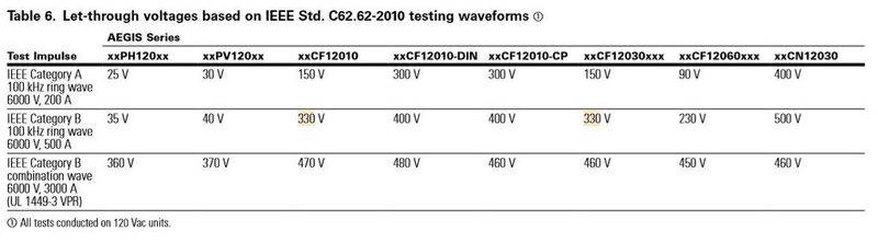

http://www.eaton.com/ecm/groups/public/@pub/@electrical/documents/content/td158002en.pdf
Table 6 of let-through voltages for AEGIS Series surge protectors under IEEE C62.62-2010 testing, listing impulse categories and voltages for each model, with 330 V highlighted in two cells.
330V is a 2nd edition thing.. but if a product under 3rd edition is 360V.. it is better than nothing.
This is time consuming to search for specs. If UL won't give me list. Perhaps I could just get the very expensive $380 Erico.. but it hurts the pocket. I could have better spent it elsewhere.. or maybe will settle for the Leviton 5100-PS which has 600v VPR. It goes back to this important question. What part of electronic circuits really get damaged by quick 600v surge? If none and it won't heat up.. then I guess we all can settle for 600v VPR at fraction of cost of 330v VPR SPD type 3 that we are not even sure is such (for example the 175Vac MCOV Erico). Say aren't others interested in surge protectors? We all can benefit from this so please ask your nearest UL representative to get the listing.

I find something very useful. One can see all UL listed products here:
http://productspec.ul.com/document.php?id=VZCA.E109835
The above is example of all Eaton listed UL products.. you can see only their MCOV of 127Vac can make it to 330V VPR.. while for 150Vac MCOV.. the VPR average is 600 volts.
Now the following is for Erico:
http://productspec.ul.com/document.php?id=VZCA.E325047
Their average VPR for 150Vac MCOV is 800Vac! The TSF5A120V is not listed. Therefore the 330V rating for this may be from older SVR.
Now for Belkin product: http://productspec.ul.com/document.php?id=VZCA.E152555
Their power strips being sold at amazon all have MCOV of only 127Vac.. (too close to 120Vac!)…
Therefore conclusion. There is no product that is actually tested for MCOV of 150Vac and VPR of 330V. All VPR of 330V either are below 150Vac or the older SVR 2nd edition. Can anyone contest my statement?
If I'm right. Then a 150Vac MCOV and VPR of 500 to 600v is the optimum spec for SPD type 3 and there is no VPR of 330V for 150Vac or higher MCOV. All else is fake news.. (Hence Erico spec for the TSF5A120V was from 2nd edition data using much weaker surge current).
I checked many products in the Surge Protection Section at the UL sites above. There is none literally of 330vac VPR under 150Vac MCOV. Only for 127Vac MCOV. And 127Vac is too close to 120V and fire hazard. So I finally ordered 3 pcs of the Leviton 5100-PS with listed VPR of 500Vac and 150Vac MCOV. NOw transformer is supposed to have impedance so I can remove my 5 meters of loop. But how exactly do you calculate for transformer impedance and equivalent wire length (10 AWG) so it equals 5 meters.. so I can start searching for 220v-110v step down transformers?

No. I won't experiment by tapping the 208 volts because I don't want the electrician to accidentally make wrong connections and trip the breakers. I'll just try to see the wires from distance using my high resolution binocular. But here is the picture of the actual transformers.
The middle terminal at right transformer is not wired.. but the middle terminal of the left transformer is wired.. based on the image.. is the neutral tapped to centertap? What is that thing above the red arrow?
Two pole-mounted distribution transformers on a utility pole with many cables, one marked with a red arrow pointing at a bushing on its upper side.
Do you have exact wiring illustration for 3 phase open high leg delta transformers that connect to only 2 out of 3 wires in the primary high tension (I heard they use the 3rd wiring using the ground) see: https://www.practicalmachinist.com/...nd-vfd/three-phase-only-two-wires-wtf-103191/
  • Photo of two pole-mounted cylindrical transformers on a utility pole with a red arrow pointing to a bushing on the left unit, with overhead power lines and trees behind.
  • Two pole-mounted distribution transformers on a utility pole with many cables, one marked with a red arrow pointing at a bushing on its upper side.

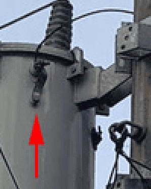

I can't see centertap of far transformer. Is there a wire on it ? I see only two wires coming down from that transformer.
Thing above the red arrow should be the primary winding's low end termination and the ground wire..
Here it is at 300%
Close-up photo of a utility pole transformer's grey tank with a porcelain bushing at top, a red arrow pointing to a dark cable termination on its side, and wires running to a crossarm.
  • Close-up photo of a utility pole transformer's grey tank with a porcelain bushing at top, a red arrow pointing to a dark cable termination on its side, and wires running to a crossarm.
Here it is at 300%
Here is the front of the far transformer. so do you think it's tap to centertap overall?
Photo of a pole-mounted distribution transformer with a grey cylindrical tank, a black cover at its base, and a label reading AMDT 75 with a smaller black nameplate below; several cables run down the side.
  • Photo of a pole-mounted distribution transformer with a grey cylindrical tank, a black cover at its base, and a label reading AMDT 75 with a smaller black nameplate below; several cables run down the side.
Seeing the full pictures of the 2 transfomers.. is the wiring like the following?
Wiring diagram titled Open Wye-Open Delta showing two pole-mounted transformers on a utility pole, with phases A, B and C at the top crossbar, a ground connection at the right, and labels H1, H2, H, X1, X2, X3 and P on the transformers.
There are only 2 wires connected to the 3 high tension wires above.. where exactly does the 3rd phase wire pass by to create 3 phase? I read it's from ground? how? And why is there a Wye? Maybe the above is not illustration of my 2 transformers.. do you know where to find illustration of wiring of my two transformers? And what does P in the right wire mean? Thanks a lot!
  • Wiring diagram titled Open Wye-Open Delta showing two pole-mounted transformers on a utility pole, with phases A, B and C at the top crossbar, a ground connection at the right, and labels H1, H2, H, X1, X2, X3 and P on the transformers.
I can't see all the wires between the two transformers' low sides
It does appear there's a wire on centertap of the last one you posted.
but i don't see it earthed(grounded)
Label the three corners of an equilateral triangle A B and C
find its center (equidistant from each apex) and label that Neutral.
Ground neutral for this exercise, but be aware it doesn't have to be grounded.
Now draw a line from each apex to neutral.
You now have a vector representation of a three phase voltage system
six distinct lines representing six distinct voltages, each with a magnitude and direction.
the outside ones are Delta and the inside ones Wye...
voltage from phase A to phase B is the line connecting those two apexes
and voltage from phase A to Neutral is the line from A to Neutral
We usually designate them Vfrom-to eg VNA would be From N to A,
and so on
(i draw tail of vector at FROM end and head of vector at TO end, but that choice is made by your textbook author)
then recall from grade school geometry that two sides and an angle is all you need to define a triangle.
Now - voltage from any two phases to neutral and the 120 degree angle between them completely defines that triangle and all six voltages.
Cool, huh ?
Who said three phase is hard you just got to be meticulous.
..... anyhow....
On primary side neutral is grounded
so all you need is two phases and neutral (which is ground on distribution side)) to establish the voltage triangle.
That's why there's only two high voltage wires
and ground
and a wye.
It's Electric Company;s choice. They save a transformer and some insulators and only have to maintain two HV connections..
You really should go through that drawing exercise for your edification,
(EDIT we actually call the lines "Phasors" but you treat them just like vectors)​

but that's the leg that'd read 208 to neutral. In the US we call that one the "Wild Leg" . Is there a synonym for "wild" that starts with "P" ?

What is that isolated piece of metal above below the middle wire.. I went to look at the transformer again. The wire at middle is connected to the neutral of my service panel and it is also connected to the rod stuck at concrete beside the pole. Is this enough to ground it.. or does grounding means the isolated piece of metal has to be connected to ground as well?
In the image below. It's bottom shot. The neutral tap at middle terminal is connected to the wire between poles.. isn't it the ground or is the ground the isolated piece of metal in the pic above?
I just want to make sure the utility company follow local codes.. because if they themselves don't follow and we don't know.. we can't do anything.
  • Cylindrical utility transformer hanging from a wooden pole, with several black cables routed around it and horizontal power lines behind.

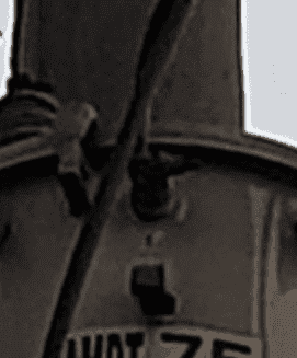

This ?
Photo of a grey pole-mounted transformer tank with a red outline around a small metal boss, and the label ANDT 75 printed on the tank.
That's a connection point to :"bond" (connect) the low side centertap to the transformer's metal tank,
The practice in US is to ground every system at its source, and that transformer winding is the source for your building.
So placing a strap from centertap to that metal 'boss' connects it to the tank and the tank is grounded as in this photo from post # 195.
Photo of a pole-mounted transformer tank with a green outline around a bonding strap clamp, an arrow labelled "Neutral is earth", and a white callout reading "Neutral wire to house".
Good! Now that's established as fact by direct observation.
Well at least it's grounded...
I don't think it's isolated, it's welded to the tank and the tank is grounded.
So the question becomes "do your local authorities accept your connection down by the pole as "grounded at the source" ?
So far as i know here in US we interpret "at the source" to mean right at the transformer terminal. That;s why the provision for it there.
Your county might prefer separate grounds for primary and secondary - i don't know. That's a question for your electrical inspector and city engineer .
This ?
Photo of a pole-mounted distribution transformer, a cylindrical metal tank hung from a utility pole, with a red hand-drawn circle marking a grounding strap connection point on a lead cable at its lower side.
That looks to me like the Neutral. Did they connect it to a wire or rod buried in the Earth ? You mentioned a rod near the pole...
Next time you see an electric company truck working, stop and talk with the crew. Ask them about grounding , how do they connect Neutral to earth.. They'll probably be happy to share their knowledge.

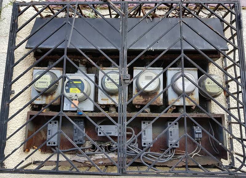

For example. In my home. I noticed my service entrance has the uninsulated neutral wire too, however after the meters, the old building contractors didn't put any lines .
Row of five electricity meters mounted on a wall behind a black iron gate, with exposed wiring and rusted metal shelves below.

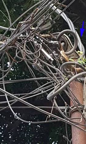

Notice the lower wires getting inside the 6 apartments, there is no more ground from the neutral wires. Our city hall never check for ground, it is not a requirement that is why we have millions of homes without ground wires. Fortunately there is at the service entrance wire (in blue below):
Photo of a utility pole with a tangle of overhead wires, cables and loops wrapped around the pole top, and a blue arrow pointing at the cable run on the right.
I've talked to some local electrical engineers. They totally have no experience in grounding. My question is, if I'd let them tap the neutral at service entrance (with permission from the utility company) and put grounding wires to inside my house about 50 meters away (164 feet away) from the main panel breaker above and the total single phase amperage is 120 ampere.. what is the rule for the size of the grounding wire? Do you have reference for grounding wires sizes? Local electrical engineers are not sure because they rarely deal with ground. One commented to use the full live load wire size.. but then the grounding is only to trip the breaker for short instance or pulse.. so what is the minimum size for this? Of course I'll still discuss this with the engineers but just want some ideas as they don't know. Many thanks.
