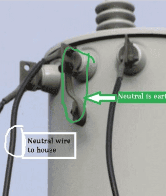

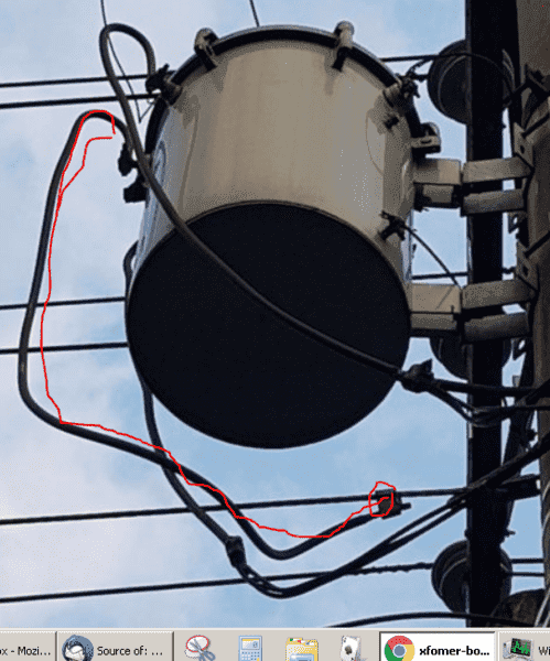

Something is wrong in our ground or neutral because in my country compared to US, (to summarize briefly) we used your split phase 120/240V phase to phase power system to power our buildings with government complied 240 volts. We don't use phase to neutral 120 volts nor use neutral to ground bonding at panel. Therefore the neutral in the Open Delta transformer is connected to our breaker panel as ground (no separate ground). In most homes without Open Delta transformations. I have confirmed there is not even ground or neutral wires coming to the house. For the particular Open Delta supplied building like mine. Our ground is neutral wire connected to the transfomers. Now since we don't have separate neutral and ground. I'm afraid the Siemens device will keep sounding alarm (as well as all other brands of 120/240v split phase surge protectors at amazon). Any idea how to make proper neutral and ground so it can be connected to the proper Siemens leads without sounding fault alarm.. this is illustrated thus:
Wiring diagram of a FirstSurge surge protector installed beside a breaker panel with lettered bus bars A, C, N and G, showing lead routing and installation notes.
Again my transformer Neutral is used as Ground in our building without separate ground. If our aircon housing is connected to neutral in the transformers. What problem would this produce and what is meant by ground to neutral fault in the US that can cause problem with the Siemens Device.

In the U.S., the Ground and Neutral are connected together. Apparently the Siemens SPD checks this connection and complains if they are not connected.
This refers to the SPDs in the breaker box. The type 3 at the equipment, if any, is addressed below.
1) CHECK WITH YOUR POWER COMPANY to see if this is both safe and legal before you do this step. This suggestion is based on the U.S. National Electrical Code (NEC) and may not be appropriate where you are located.
From a safety and effectiveness standpoint, drive an 8 foot ground rod into the Earth near the breaker panel. Then run a wire not smaller than the service entrance conductors from the ground rod to the breaker box. Make the wire run as straight as possible and any needed bends should be gentle (large bend radius), not sharp 'square corners'. The gentle bends present a better path for high current lightning strikes, sharp bends tend to induce any high voltages to jump to other nearby conductors.
  • Now you have two options:
    • Connect the new Ground wire to the Neutral in your breaker box AND to the ground wire of the SPD.
    • Connect the new Ground wire only to the ground wire of the SPD.
2) If the above is not possible/practicle, to disable the alarm on the SPD, connect the SPD ground wire to the same place the SPD neutral wire is connected. (not ideal, but better than nothing.)

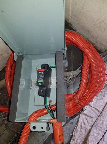

I was asking this yesterday to possibly justify not adding 5 meters of wire to existing 5 meters to comply with UL minimum 10 meters to equipment.. but 2 hours before your reply before we already installed it with electrician:
Surge protector mounted inside a grey metal enclosure with its cover open, wired with a green ground wire and black conductors, with orange corrugated conduit entering from the right.
It's Prosurge 50,000A surge capable Type 2 with 5 meters of wires in loop added to existing 5 meters making up 10 meters from main breaker panel and besides the equipments (the green wire is existing and I know I made wrong color choice years ago, the black wire is the additional 5 meters). This is pictured energized so all is well. Now this question is just to clarify above and academic (since I already installed it). You said type 3 can see the service entrance wires which has low impedance and type 3 supposedly have lower surge current capability. I don't get it. If it has type 3 with low surge current capability.. why can't low impedance be enough for it? Isn't it low current and low impedance go together? Because you seemed to be implying low surge current capability type 3 needs high impedance?
And for my actual implementation (temporary as I'm waiting for 150Vac SPD and 220V-110V transformer implementation hence the no wire clamp is just temporary), I didn't use low surge current capable type 3 but the samehigh 50,000A surge current which I now put both at breaker panel and 10 meters away from it near equipment. So how does this change your statement about "The problem arises due to the relatively low service entrance impedance and the lower current capability of the type 3 SPDs" as it pertains to whether the type 3 can see the service entrance wires. With my high current surge type 3.. what would it see? Should the 10 meters requirement be theoretically increased or decreased if high surge current type 3 is used?
Thanks.
Thanks.
Let me reword this last inquiry about impedance as I'm quite confused by it and can't shake the feelings.
1. You said the service entrance has low impedance... this means the SPD 1 & 2 are not so effective in lowering the voltage because it needs high impedance?
2. You need 10 meters to SPD 3 at equipment so the SPD3 there can lower the voltage more effectively.. but can't the type 1 or 2 at breaker entrance sees the 10 meters wire from it to the SPD 3 or does it only see the low impedance at service entrance wire?
3. Does this mean service entrance wire should be long so it would become high impedance for the Spd 1 & 2 to decrease the voltage more effectively...
4. What's so confusing is why is impedance needed to lower voltage. If you have a stand alone SPD with high voltage introduced to it.. the mere fact the MOV conducts means the voltage difference is lowered.. why is impedance important? Wikipedia defines impedance as: Electrical impedance is the measure of the opposition that a circuit presents to a current when a voltage is applied. So I can't quite get why it is need to bring the voltage down. I'm quite dumb in this thing. Appreciate a million for your help Tom!

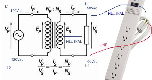

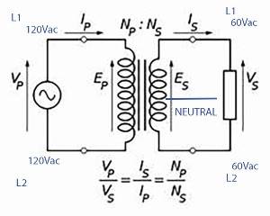

If my description was vague since I'm not a native.. here's an illustration:
Wiring diagram of a FirstSurge surge protector mounted beside a breaker panel, with breaker labeled BREAKER, bus bars A, C, N and G, and blue notes reading 120Vac; text lists installation tips including keep leads short and outdoor weather sealing at the nipple.
You are to connect the line 1 and line 2 leads of the Siemens to each of the 120 Vac power wire making up 240volts... but what if you put 220v-110v step down transformer in phase to phase ac supply wires turning it into 110 volts.. then you can't no longer use the same line 1 and line 2 leads in the transformer output of 120 volts because the MOV in series is rated at 300Vac.. you are supposed to connect now the Line 1 and neutral to the 120v output of the transformer (that has phase to phase input) right?
  • Wiring diagram of a FirstSurge surge protector mounted beside a breaker panel, with breaker labeled BREAKER, bus bars A, C, N and G, and blue notes reading 120Vac; text lists installation tips including keep leads short and outdoor weather sealing at the nipple.
kiki_danc said:
Now I'm asking if I can connect the Siemens FS140 line to neutral leads to these 120 volts line to line output from transformer? Remember the line to line leads in Seimens FS140 was supposed to be connected to each of your 120 volts phase to create 240 volts..
Yes. Connect the Neutral lead of the FS140 to the wire that goes to the Grounded secondary terminal of the transformer. The Line leads of the FS140 get connected together then to the wire that goes to the other transformer terminal. And of course the FS140 Ground wire goes to your newly installed Safety Ground.

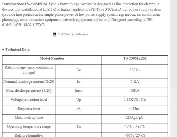

No. Transformer setup is supposed to be a permanent solution because clamping voltage of type 3 is same as type 2.. the lower figure of strip surge protector you saw at amazon is because it uses UL 1449 second edition test vector which uses 6000 volts and 500 ampere only while UL 1449 third edition use 3000 ampere... but if all will use same third edition, result is the same... clamping voltage is dependent on MCOV only and not the surge current rating.. the following is example of a type 3 that uses third edition test vector and it still has 1100 volts clamping voltage.
http://www.tslpro.com/en/ka-type--surge-arrestor-58.html
Datasheet table for TS-230M5RM Type 3 surge arrester: Uc 320V~, In 5 kA, Imax 10 kA, Up 1.15 kV (L-N), tA 25 ns, back-up fuse 125 A gL/gG, operating range -40 to +80 °C, humidity below 95%.
  • Datasheet table for TS-230M5RM Type 3 surge arrester: Uc 320V~, In 5 kA, Imax 10 kA, Up 1.15 kV (L-N), tA 25 ns, back-up fuse 125 A gL/gG, operating range -40 to +80 °C, humidity below 95%.
I knew since 5 days ago that clamping voltage is dependent on MCOV only and not related to surge current rating. this was the reason why we discussed all these transformers options because it's supposed to be permanent.. the simplest would be to get the following 150Vac module and connect it to my transformer 110v output...
Photo of a ProSurge SP150 single-module surge protective device with a green-and-red status window and a red-and-black top cover, labelled N/PE at the base.
But I want to try other US brand (prosurge is made in china).. this was why I was asking how do you connect the Siemens to the transformer t to make use of the one 150Vac MOV only. if you will connect the line 1 and line 2 to the transformer output of 120 volts.. you will still have MCOV of 300Vac inside the Siemens.. any idea? Because if not possible then I have no choice but to get the above..
Of course if type 3 with lower surge current indeed have lower clamping voltage.. then of course i'll get a type 3...
  • Photo of a ProSurge SP150 single-module surge protective device with a green-and-red status window and a red-and-black top cover, labelled N/PE at the base.
Can anyone prove that clamping voltage is related to surge current rating? I think it's primarily connected to MCOV only.. the following is a background brief about it from a GE SPD page:

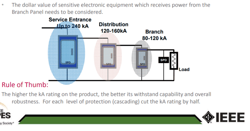

Meantime i found and saved this presentation to get myself more current(no pun intended) on the subject
file:///C:/Users/Owner/Downloads/IEEE%20Surge%20Protection%20Presentation.pdf
Diagram of a three-stage surge protection cascade on a branch circuit: Service Entrance up to 240 kA, Distribution 120-160 kA, Branch 80-120 kA, each stage marked with an SPD, feeding a load.
EDIT SOURCE - beware, this stupid IEEE link doesn't open a page , it directly downloads the presentation to your C drive without asking !
Google search results page for 'ieee surge protection presentation', with a red hand-drawn arrow pointing to a PDF result titled IEEE Surge Protection Presentation.pdf from ieee-sfv.org.
perhaps some of you IEEE members can access the standards it references.
and tell IEEE for me
"Gentlemen do not write on other gentlemen's computers without permission!"
So while i know this post hasn't really contributed to the thread , and i apologize for that
thanks for tolerating an old guy trying to get himsellf up to where he can help. I've jotted down the links here for my own reference but if they help anybody else I'm overjoyed.
Been a lot of progress in the last fifty years, i'd say. I have miles to go before i speak on this topic...

Let me illustrate the above with the following image:
Schematic of a 120Vac transformer with primary and secondary voltages, labelled NEUTRAL and L1/L2, beside a photo of a Siemens FirstSurge surge protector box with red annotations reading 60Vac, 300VAC MOV ENGAGED and SIEMENS.
Maybe you meant connecting L1 and L2 of the Siemens to L1 and L2 of the transformer secondary and connecting the neutral to the center tap??
But then the MOV that would be engaged in the Siemens would be two 150Vac Mov making up 300Vac... so using it for 120 volts would produce too high clamping voltage.. I was asking if you could connect the L1 of the Siemens to the L1 of the transformer secondary and neutral of the Siemens to L1 of the transformer secondary?? That way you can engage only one 150Vac MOV of the siemens L-N connection.
Clamping voltage seems to be the same for type 2 and type 3 given the same pulse of 6000V and 3000Ampere. I'm looking for a theoretical justification. Anyway I think the best power strip in amazon is this:
https://www.amazon.com/gp/product/B0009K66KY/?tag=pfamazon01-20
The spec is in the message earlier. It passed UL third edition test. So if the Siemens would detect fault if line 1 and line 2 is shorted like you asked, then I guess the solution would be this power strip to make use of the line to neutral MOV... the strip won't sound alarm. This is because I can't find individual MOV module like prosurge which is made in china.

Tom. Since you only surf a few moments in the evening.. let me ask this now so I can decide whether to get this:
If you really meant connecting L1 and L2 of the Siemens to L1 and L2 of the transformer secondary and connecting the neutral to the center tap (right?) as detailed in the message prior to this. Then there is this problem of using total of 150Vac+150Vac MOV since L1 to L2 in the siemens is 300Vac. I only want to use 150Vac MOV across L1 and L2 of the 220v to 110v step down transformer. Would the following work?
Left: schematic of a transformer with primary voltage Vp, Ip, Np turns and secondary Vs, Is, Ns turns, labelled 120Vac on each side, with a 60Vac output and NEUTRAL marked at the center tap. Right: photo of a power strip with a cord and labelled LINE and NEUTRAL, plus a 150VAC MOV note.
That is. The L(ine) of the Leviton power strip would be connected to L1 of the transformer secondary and the N(eutral) of the Leviton power strip would be connect to L2 of the transformer secondary (while the ground is either left hanging or connected to future ground line).. would this work?? Can this trick the L-N of the Leviton power strip to connect to L1 and L2 of the transformer secondary to limit it to 150Vac MOV across the 120 volts secondary transformer output? If yes. Then I'd buy this since the Siemens split phase circuit may not be tricked. Thank you.
  • Diagram of a step-down transformer with primary Np and secondary Ns, labelled 120Vac on L1 and L2 at input and 60Vac at output, with the NEUTRAL marked on the secondary; beside it a photo of a power strip with blue NEUTRAL and red LINE wire routes drawn over it.
  • Left: schematic of a transformer with primary voltage Vp, Ip, Np turns and secondary Vs, Is, Ns turns, labelled 120Vac on each side, with a 60Vac output and NEUTRAL marked at the center tap. Right: photo of a power strip with a cord and labelled LINE and NEUTRAL, plus a 150VAC MOV note.
kiki_danc said:
did you mean Line 1 and Line 2 are shorted together and connected to one lead of the secondary.. while the other lead is connected to neutral
Yes.
kiki_danc said:
(and the center lead to ground)?
What center lead?
kiki_danc said:
But won't the Siemens sound fault alarm if line 1 and line 2 are shorted??
Unlikely from the product description

Edited source for that informative IEEE Surge presentation in post 143 , see cautionary note
