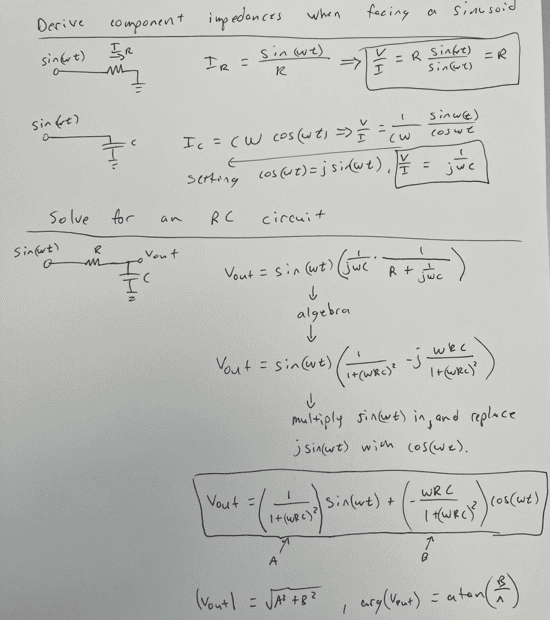

In circuit analysis, everything seems to work out when you set i*cos = sin. But thats not a legitimate equation, so why does that work? Is there a proof that this is a real equation?

sin(wt) across a cap gives I = c*w*cos(wt). So V/I becomes 1/jwc. It works everywhere else too
So where is ##i \cos = \sin ## in that?
should be i*sin = cos, sorry. V/I = sin/(cwcos). replace cos with jsin and it simplifies to 1/jwc
another example:
i have a transfer function given by the complex number (A+jB). I multiply my input sin(wt) and i get Asin(wt)+jBsin(wt). Using the equality above, it becomes Asin(wt) + Bcos(wt), which is just standard form of any sinusoid with a magnitude of sqrt(A^2 + B^2). No need to convert into an exponential with eulers formula, then take the "real" part of that exponential.
I think you are misinterpreting the fact that $$\frac d {dt}~e^{i\omega t}=i\omega e^{i\omega t}$$ as a new "magic rule" for circuit analysis. This is just a property of a circular function.

Ok, so you seem to be mixing phasor concepts with time domain notation. So in phasor notation ##A \cos(\omega t+\phi)## is written as ##A\angle \phi## which is further interpreted as the complex number ##A e^{j\phi}##. So the phasor of ##\cos(\omega t)## would be ##1 e^{j0}=1## and the phasor of ##\sin (\omega t)=\cos (\omega t - \pi/2)## would be ##1 e^{-j\pi/2}=-j##. So ##phasor(\cos)=j \ phasor(\sin)## which does not mean ##\cos = j \ \sin##

If you are using complex numbers in circuit analysis (like a complex impedance, or your transfer function), then you are using Euler's formula* to express quantities that have both an amplitude and phase. It won't do you much good in the long run to pretend that you aren't. It's not any easier your way, assuming correct answers are your goal.

If the voltage across a capacitor is ##v= \sin(\omega t)## then the current through it is ##i = C \dot v = C \omega \cos(\omega t)## so $$\frac{v}{i} = \frac{\sin(\omega t)}{C \omega \cos(\omega t)} \ne \frac{1}{j\omega C}$$ What does work, as I said, is to use phasor notation.

Of course, if ##\omega t## is real then ##\cos(\omega t)## is real and ##i \, \sin(\omega t)## is imaginary, so they are never equal. Writing ##i \, \sin(\omega t)=\cos(\omega t)## makes as much sense as writing ##1=2##. They are both false.

That substitution doesn't work in the example that you gave in post 5. If the voltage across a capacitor is ##v= \sin(\omega t)## then the current through it is ##i = C \dot v = C \omega \cos(\omega t)## so $$\frac{v}{i} = \frac{\sin(\omega t)}{C \omega \cos(\omega t)} \ne \frac{1}{j\omega C}$$ What does work, as I said, is to use phasor notation.
Yes it does? Substitute cos(wt) with j*sin(wt) and thats exactly what you get, and kinda my entire point here.
If you make the substitution then you do get the right hand side of the inequality, but it doesn’t equal the left hand side of the inequality. In other words, once you make the substitution, the remaining quantity is no longer equal to ##v/i## where ##v## and ##i## are functions of time, not phasors.

That is exactly the problem. ##\cos/\sin=\tan\ne 1/j##
Im wondering why IT WORKS when you substitute jsin. Thats it
And I am telling you that the substitution doesn’t work.
What does work is to transform to phasors.

It might be easier if you give an explicit (excruciatingly detailed) example of what you mean. I think you will see it is not very interestng when looked at in detail. Phasors and complex notation give the same results when applied appropriately. So please give one concrete example of your substition (in gory detail)
Because of the trig identity ##A sin(\omega t) + B cos(\omega t) = \sqrt{A^2+B^2}~ sin(\omega t + atan(\frac{B}{A}))##
And
##|(A+jB) sin(\omega t)| = |(A+jB)| ⋅ |sin(\omega t)| = \sqrt{A^2+B^2} ~|sin(\omega t)|##
##arg((A+jB) sin(\omega t)) = arg(A+jB) + arg(sin(\omega t)) = atan(\frac{B}{A}) + arg(sin(\omega t))##
Then when you jump to phasor notation and drop the ##sin(\omega t)## terms they are the same. It's the same solution algorithm, that is all. Nothing Euler didn't know 300 years ago. If you aren't working with phasors, it's just wrong.

So the analytic representation of ##A \cos(\omega t+\phi)## is ##A e^{j\phi}e^{j\omega t}## and the phasor representation is the non-time-dependent part ##A e^{j\phi}##. So the phasor representation of ##\cos(\omega t)## is ##e^{j0}=1##.
Since ##\sin(\theta)=\cos(\theta-\pi/2)## the phasor representation of ##\sin(\omega t)## is ##e^{-j\pi/2}=-j##.
So $$phasor(\cos(\omega t))=j \ phasor(\sin(\omega t))$$ This is where the relationship you are seeing comes in. But this in no way implies that $$\cos(\omega t)=j \ \sin(\omega t)$$ That substitution does not work for the reasons I showed above.
You are just being sloppy. You need to clearly identify when you are working with functions of time and when you are working with their phasor representations. A function is not the same as the representation of that function in another domain.
Similarly, when you are working with Fourier transforms you need to be clear about when a function is in the time domain and when it is in the frequency domain. If ##X(\omega)=\mathcal F [x(t)]## then $$\mathcal F[ \dot x]=j\omega X$$ is correct whereas $$\dot x=j\omega x$$ is simply wrong. This is what you are doing and claiming that it works. Sloppy mixing of domains doesn't work.
