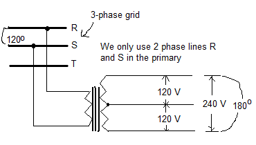

I think what James was trying to say is that even in US, the power plants would produce 3-phase current (each 120o out of phase from the other two) with no neutral wire. This is transmitted by power lines to local distribution points. At those points, depending on the power consumption, you might be given either 3 or 2 of the power lines.
If you are given 2 lines, this is single phase. Then, you have a transformer of the split-phase type: there is a neutral wire in the middle of the secondary of the transformer. The (effective) voltage between each end of the secondary and the middle is 120 V, but the ends are at a phase difference of 180o, so the voltage between them is 120 - (-120) = 240 V. You are still connected between two phases of the grid though.

You forget the transformer. We are simply saying that at the secondary end of the transformer, the (effective) voltage between each end and the middle is 120 V. I don't know what is the interphase voltage on the primary.

Look at this setup:
This is what I was trying to say.

You have just described exactly one of the situations I outlined back in post#3, so we are in now agreement.
But I just checked post#5 and I couldn't find a single reference to a transformer.
Sorry for the confusion guys. There are 2 methods that are common in the US to get to a residency. If it is a low occupancy home, it is probably fed by a distribution split-phase transformer as Dickfore showed;
