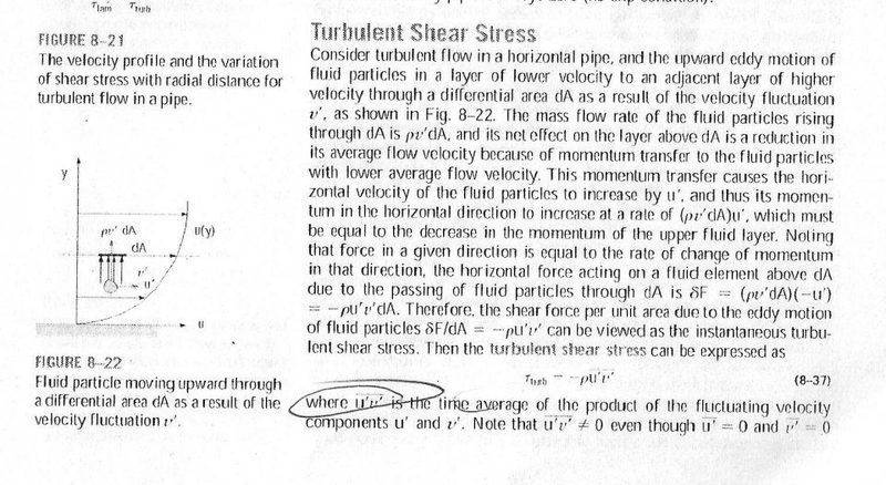

what is the meaning of the circled time average there? does it mean ( (ms^-1)(ms^-1) ) /2 ?
No. It means
$$\frac{\int_0^T{u'(t)v'(t)dt}}{T}$$
