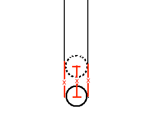

Take a look at this picture I made (it's harder to explain with words).
If the pulley goes down by x then the rope gets longer by ?
It will get longer by 2x.. Thanks for your nice illustration..
Then the piece EB decreases x in length and AB also decreases x in length, right ?
So, the velocity of pulley D is 0.5 ( vA + vB ), right ?
Then, how to find the relation between the acceleration ?
Correct.
Well, EB and AC don't necessarily have to decrease by the same amount.
Yes :) this is correct (ignoring directions). Also, Va does not necessarily equal Vb, but their sum must get shorter by 2 m/s
