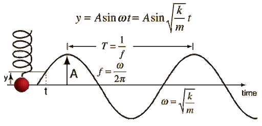

Hmm, not quite. Let's forget about the business with the reducing amplitude for now. Just focus on the oscillatory motion with no damping.
If you have a vertical spring with the mass attached to the bottom, and you give the mass a little push downward, it starts to vibrate up and down, right? Say you recorded how high it was every 0.001 seconds (you're very patient... and fast!). You then plot the height of the mass against time on your graph. What would a graph of it's height against time look like (take ##h=0## to be where you release the spring from, just for simplicity).

Not really. If there's no damping then the thing's just going to keep oscillating up and down forever. Up and down... rinse and repeat... try getting a large rubber band and hanging a mass on that, and giving it an initial push. What motion results?
How about, something like
Close enough. Which of the given choices most likely would look like this when plotted?
That's more like it! Sort of.
For undamped SHM, you'll get a perfect sine/cosine:
Note that the ##x## axis is still the centre of the oscillation, there's no migration of the centre of oscillation downward as you have drawn.

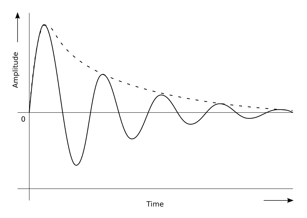

You've sort of jumped the gun and have started reducing the amplitude. If you do damp the motion you end up with a graph like this:
which is similar to what you drew. Now, you're in a position to answer the question. What two functions does this second graph remind you of?
I'm now going for
x = exp(-b t) sin(a t)
Yeah, that's the one.
The ##e^{-bt}## bit is called an envelope function. In this case, it's always less than 1 for ##t> 0##. You can imagine first drawing the sine wave, and then going along to every point and scaling the displacement by a factor of ##e^{-bt}##. This factor gets smaller as time progresses, and the amplitude of oscillation just gets smaller and smaller. Makes sense intuitively, right?

The first choice represents nothing physical; what happens at t = 0?
The second choice is a special case of a critically damped harmonic oscillator.
The third choice represents an underdamped harmonic oscillator.
The fourth choice represents harmonic motion without damping.
