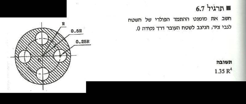

We've always been using mm^4, but I see in my answer book (answer written below) that one solution says R^4. Is it the same thing, just that R^4 is used for a circle? The measurement in my exercise are in mm.
I did get the answer, I just wasn't aware I was supposed to write it in terms of R^4.

I think R is just a constant used to give the radiuses, and is not a unit. Moment of inertia/second moment of area should have dimension [length]4.
So was I correct to put in my answer 1.35 mm^4? (that's what come out if you do the calculations for polar moment of inertia on this object)
Well, if the units of R are not given, I would leave things in terms of R.
The units of R are mm^4 :) So I was correct, yes?
Did you leave the R^4 in? (1.35mm^4 is not 1.35*R^4 mm^4)
If so, yes. Otherwise, (without having done the problem) I'd say you were off by a factor of R^4 based on what I presume is the answer key up there.
I see. I'm not quite sure I have the intuitive understanding of "why" I need to add that R, I thought that R is just a part of the formulas for polar moment of inertia, and then you just leave the result "as in" and add the units.
This is a different R, and is a constant used to give the lengths you need to put into the formula.
So, the radius for the big circle is r=R, so you'd plug in R for r in the formula, and similar for the other parts.
For that matter, let's do something simple, finding the area of the big circle. A = πr2, of course, and since the big circle is radius R, you'd get A = πR2. Same idea for area moment of inertia.

But the radius is not 1, it is R. (R is a number here, it is not the r in the formula. You plug R into r.)
Think algebraically. If I gave you f(x)=x^2 and told you to find f(B), what would you do? It's the same with r and R.
Femme_physics said:
So I add it to every moment of inertia of circular objets calculations? Is it just for polar moment of inertia?
The various radiuses given in terms of R would still have Rs.
Looking at your diagram the radii are not given in mm so your answer cannot be in mm4.
The outer radius of the disk is R
The pitch circle of the holes is 0.5R
The radius of the holes os 0.25R
Whatever R is.
If you like R is a scale factor.
This is not the usual engineering drawing convention where R stands for radius and the units are understood. If that was the case then R would not appear in the answer.
Whatever R is.

Your final answer is correct, but I'd leave the R in in your calculations. R is arbitrary, so if you want a general solution you can't redefine R.

In your calculation you have set R to 1.
I assume that is something your teacher did as well, did he?
However, this is a bit tricky.
This is because R is an unknown quantity that has not been given.
R might for instance be R=1 mm, which is basically what you have done.
Then you would get the result you calculated in mm4.
That is, you would have:
I0 = 1.35 mm4.
Note that R is not included in the result!
However, suppose R=2 mm.
Then all the calculations will be basically the same, except that in the final answer there will be an extra factor 24.
I0 = 1.35 x 24 mm4
I could also write this as:
I0 = 1.35 x (2 mm)4
Or: :)
I0 = 1.35 x R4
Note that mm4 is not included in the result!

Yes, he meant that you drop mm^4 and just leave R in.
The unit is "embedded" in R.
Consider that now you have
I0=1.35 x R4 mm4
If you wanted to calculate the result for say R=2 mm, you'd get:
I0=1.35 x (2 mm)4 mm4
Which is:
I0=1.35 x 24 mm8
Somehow that doesn't look quite right...? :rolleyes:
You must leave your answer as 1.35R4.

Oh, I see what you both mean. Thanks. Still, force of habit to use mm^4. I'll just be removing the R. As long as my answer is true to my definition of R.
You really shouldn't get to attached to one particular unit (mm4)...
What if you had to deal with cm4? Or m4? Or even furlongs4?
It's best to think of area moment of inertia having dimension [length]4.
