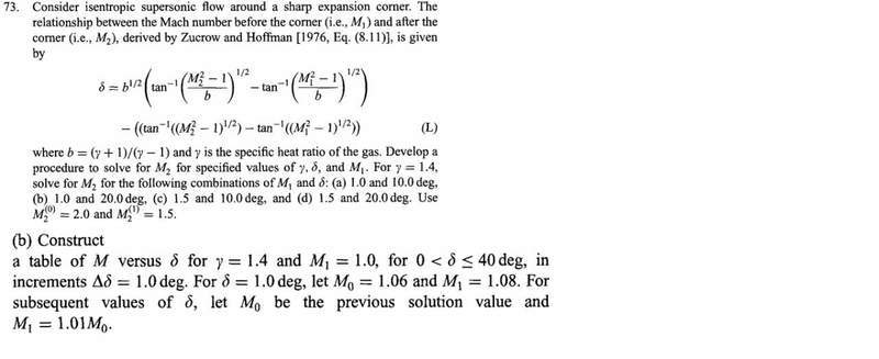

hello...i have been given an assignment which needs to be done on fortran90...i have come up with my code but it isn't working for me..
there are four parrts each specifying the values of M1 and angle for which M2 is to be calculated using SECANTS method..
here is the codde with simplified comments

i have attached the question paper for your reference

thanks to all of you for your help.
i was given the question(the link of the attachment is mentioned above)..i have managed to do the first part,having generated the values of M2 foor each combination of theeta and m1.
how do i do the second part which requires me to generate a table.?

I would make a table with two columns, one for values of M, and one for values of δ. For each row in the table WRITE an M value and the δ value.
There should be 40 rows in the table.
The quickest way to make a table with the code you have already written is to redimension the arrays to have 40 values, and give theeta(j) the values 1.0, 2.0, ..., 40.0; the array values of m(j) would all be the same, 1.0. You can make a do-loop to assign the values.
