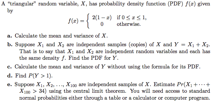

  • Printed problem set on a random variable X with triangular density f(x) = 2(1 - x) for 0 ≤ x ≤ 1, otherwise 0, with parts a through e on mean, variance, sum Y = X1 + X2, P(Y > 1), and a central limit theorem estimate of Pr(X1 + ... + X100 > 34).
chisigma said:
Posted on 07 20 2012 on www.talkstats.com by the user goodmorningda and not yet solved...
https://www.physicsforums.com/attachments/274
a) Mean and variance are computed in standard fashion...
$\displaystyle E\{X\}= \mu = \int_{0}^{1} 2\ x\ (1-x)\ dx = \frac{1}{3}$ (1)
$\displaystyle E\{(X-\mu)^{2}\}= \sigma^{2}= \int_{0}^{1} 2\ (x-\frac{1}{3})^{2}\ (1-x)\ dx= \frac{1}{18} \implies \sigma=\frac{1}{3\sqrt{2}}$ (2)
... so that is $\sigma=\mu$...
b) the Laplace Transform of the p.d.f. of X is...
$\displaystyle \mathcal{L} \{f(x)\} = F(s)= \int_{0}^{1} 2\ (1-x)\ e^{- s\ x}\ dx = 2\ \frac{s-1+ e^{-s}}{s^{2}}$ (3)
... so that the Laplace Transform of the p.d.f. g(x) of the r.v. Y is...
$\displaystyle \mathcal{L} \{g(x)\} = F^{2}(s)= 4\ \{(\frac{1}{s^{2}} - \frac{2}{s^{3}} + \frac{1}{s^{4}}) + (\frac{1}{s^{3}} -\frac{2}{s^{4}})\ e^{-s} + \frac{1}{s^{4}}\ e^{-2\ s}\}$ (4)
... and g(x) is found computing the inverse Laplace Transform of (4)...
$\displaystyle g(x)= \mathcal{L}^{-1} \{F^{2}(s)\}= \begin{cases}4\ (x - x^{2} + \frac{1}{6}\ x^{3}) &\ \text{if }\ 0<x<1\\ 4\ (\frac{4}{3} -2\ x + x^{2} -\frac{1}{6}\ x^{3}) &\text {if } 1<x<2\\ 0 &\text{otherwise}\end{cases}$ (5)
d) from (5) we derive quickly...
$\displaystyle P\{1<Y<2\}= 1-P\{0<Y<1\} = 1- 4\ \int_{0}^{1} (x-x^{2}+ \frac{x^{3}}{6})\ dx = 1-\frac{5}{6} = \frac{1}{6}$ (6)
The solution of the points c) requires the formulas that the French mathematician Ire'ne'e Jules Bienayme' found about hundred and fifty years ago about the mean and variance of the r.v. $\displaystyle X= \sum_{k=1}^{n} X_{k}$ where the $X_{k}$ are a set of n independent r.v. with mean value $\mu_{k}=E\{X_{k}\}$ and mean square error $\sigma^{2}_{k}= E\{(X_{k}-\mu_{k})^{2}\}$...
$\displaystyle E\{X\}=\mu = \sum_{k=1}^{n} \mu_{k}$
$\displaystyle E\{(X-\mu)^{2}\}=\sigma^{2} = \sum_{k=1}^{n} \sigma^{2}_{k}$ (1)
In our case is $\displaystyle n=2$, $\displaystyle \mu_{1}=\mu_{2}= \frac{1}{3}$ and $\displaystyle \sigma^{2}_{1}=\sigma^{2}_{2}= \frac{1}{18}$, so that it would be $\displaystyle \mu=\frac{2}{3}$ and $\displaystyle \sigma^{2}= \frac{1}{9} \implies \sigma=\frac{1}{3}$. Bienayme’ however didn’t give rigorousdemonstration of the fact that the (1) are valid for any n and the discussion is still open so that now we verify these results using the p.d.f. of X we found in last post…
$\displaystyle \mu= 4\ \{\int_{0}^{1} x\ (x-x^{2}+ \frac{1}{6}\ x^{3})\ dx + \int_{1}^{2} x\ (\frac{4}{3} -2\ x + x^{2} -\frac{1}{6}\ x^{3})\ dx \} = \frac{28}{60} + \frac{4}{20}= \frac{2}{3}$ (2)
$\displaystyle \sigma^{2}= 4\ \{\int_{0}^{1} (x-\frac{2}{3})^{2}\ (x-x^{2}+ \frac{1}{6}\ x^{3})\ dx + \int_{1}^{2} (x-\frac{2}{3})^{2}\ (\frac{4}{3} -2\ x + x^{2} -\frac{1}{6}\ x^{3})\ dx \} = \frac{8}{135} + \frac{28}{540}= \frac{1}{9}$ (3)
The solution of e) is also very interesting and it will be made in a successive post...
Kind regards
$\chi$ $\sigma$
The solution of the last question implies the use of the so called 'Central Limit Theorem'. Formulated in the years 1920-1930, the CLT has an enormous number of 'daddies', but in my [very modest] opinion it is the natural development of the Bienayme' result of the previous century. In simply words the CLT establishes that, given n independent r.v. $\displaystyle X_{1},\ X_{2},..., X_{n}$ each of them has an arbitrary p.d.f. with mean $\displaystyle \mu_{k}$ and variance $\displaystyle \sigma^{2}_{k}$, then the r.v. $\displaystyle X= \sum_{k=1}^{n} X_{k}$ for n 'large enough' has a p.d.f that approaches ...
$\displaystyle f(x)= \frac{1}{\sigma \sqrt{2\ \pi}}\ e^{-\frac{(x-\mu)^{2}}{2\ \sigma^{2}}}$ (1)
... where...
$\displaystyle \mu=\sum_{k=1}^{n} \mu_{k}$
$\displaystyle \sigma^{2}= \sum_{k=1}^{n} \sigma^{2}_{k}$ (2)
In our case is n=100 [we suppose it 'large enough'...], $\displaystyle \mu_{k}= \frac{1}{3}$, $\displaystyle \sigma^{2}_{k}= \frac{1}{18}$ so that is $\displaystyle \mu=\frac{100}{3}$ and $\displaystyle \sigma^{2}= \frac{100}{18}$. Now the probability $\displaystyle P\ \{X>x\}$ is given by...
$\displaystyle P\ \{X>x\}= \frac{1}{2}\ \text{erfc}\ (\frac{z}{\sqrt{2}})$ (3)
... where is $\displaystyle z=\frac{x-\mu}{\sigma}$. For x=34 is...
​$\displaystyle P\ \{X>34\}= \frac{1}{2}\ \text{erfc}\ (\frac{1}{5})= .388649... $ (4)
Kind regards
$\chi$ $\sigma$
