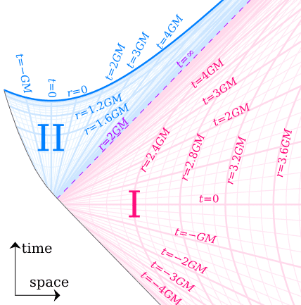

Here is a spacetime diagram of a collapse to a black hole, which first appeared in Oppenheimer-Snyder model of star collapse, post #64
Here are some selective quotes from that post:
DrGreg said:
The pink grid shows the exterior Schwarzschild coordinates. The blue grid shows the interior Schwarzschild coordinates (that is, inside the event horizon, but still outside the collapsing matter). The purple dotted line is the event horizon. The thick blue line is the singularity.
DrGreg said:
The grey line from the bottom to the left is the border of the vacuum region, i.e. the outermost layer of the collapsing matter.
DrGreg said:
The pink curves are the worldlines of observers hovering at a constant distance from the centre of the collapsing matter, and the radial pink lines are lines of simultaneity for such observers as determined by the convention of Schwarzschild coordinates. For these observers, none of the events in the blue region occur "simultaneously" with an event on the observer's worldline, so you could say the event "never occurs" (within finite time) relative to that observer. But that is just an artefact of the coordinate system chosen. It's unreasonable to say those events "don't exist".
yprager said:
... Had it taken infinite amount of time for a black hole to form in the remote observer frame of reference -- well, there would have been no black holes in her frame of reference...
You miss the point. If the remote observer is dumb enough to fall for an optical illusion, then yes they would conclude that it doesn't exist, and of course it doesn't exist visually for them but if they understand physics, they would conclude, as DrGreg pointed out, that this is just a visual illusion based on their coordinate system and that while the illusion certainly is visually real for them, it does not reflect localized reality at the site of the black hole, just localized reality for them. Cosmology is confusing that way.
