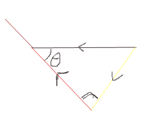

I wanted a flat surface because I was conducting an experiment on how the lift force changes with the angle of attack of the flat surface. I needed uses of the lift force to justify my choice of experiment, so I came here after finding none. Well, anyway thanks to that I got a ton of examples, so thank you to all contributors.
After conducting the experiment I can say that in my case at least, the lift force vs the (sine*cosine) of the angle of attack is linear, and there is a non-zero constant because I used a box of air with a flat lid. I also found a paper on a similar experiment if anyone is interested, and the results did agree with what I found. Though, I must admit that my conditions were not always exactly controlled, so there are some fluctuations in my data. The relationship is clear anyway.
