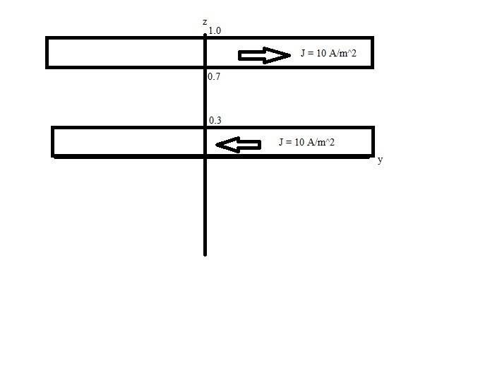

Let the regions 0 < z < 0.3 m and 0.7 < z < 1.0 m be conducting slabs carrying uniform current densities of 10 A/m^2 in opposite directions. Find H (the magnetic field intensity) and different z positions.
Biot-Sarvot Law: H = ∫ (I dL X r)/ (4∏R2)
Ampere's Circuital Law: ∫ HdL = I
I am guessing we have to apply ampere's law to each slab, in a rectangular loop. The slabs extend infinetly in the y and x axes. But I got no clue on exactly how to apply this law :( Any help would be appreciated as this my first post here.
Thanks!
  • Diagram of two horizontal conducting slabs on a z-axis, the upper slab between z = 0.7 and 1.0 with J = 10 A/m^2 pointing right, the lower slab between z = 0.3 and 0 with J = 10 A/m^2 pointing left, both extending along the y-axis.
