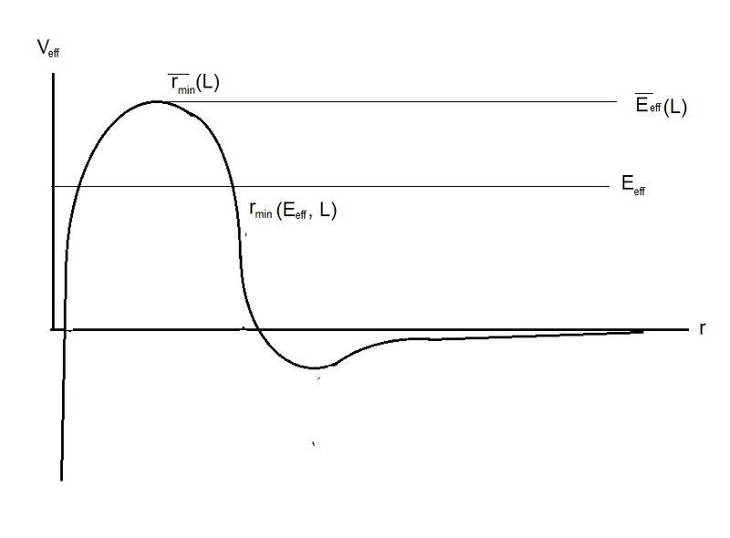

To confirm, if anyone needs it besides me, what @PeterDonis said,
If I computed it correctly, the formula for [itex]r_{min}[/itex], the closest approach for a hyperbolic orbit is:
[itex]r_{min} = L^2 \pm \sqrt{L^4 - 3L^2}[/itex]
(in units where [itex]c=1[/itex], [itex]2GM = 1[/itex])
There is no solution unless [itex]L^4 - 3L^2 >0[/itex], so [itex]L > \sqrt{3}[/itex]. So the smallest [itex]r_{min}[/itex] can be is 3.

If [itex]2GM = 1[/itex], doesn't this mean that [itex]r_{min} = 6M[/itex] in the other common units (c=G=1)? Does not sound right somehow...
Jorrie said:
It is also not clear from MTW whether that equation is precise only at the turning points, or everywhere in Schwarzschild coordinates.
It's exact everywhere. It's straightforward to derive that equation from the geodesic equation. I don't have my copy of MTW handy right now, but I'm pretty sure they discuss this.
Jorrie said:
Any geodesic that is even slightly 'in-going' at 4M should spiral in, because there is no maximum effective potential below that.
Huh? The maximum effective potential continues to increase all the way down to the (unstable) circular photon orbit at ##r = 3M##.

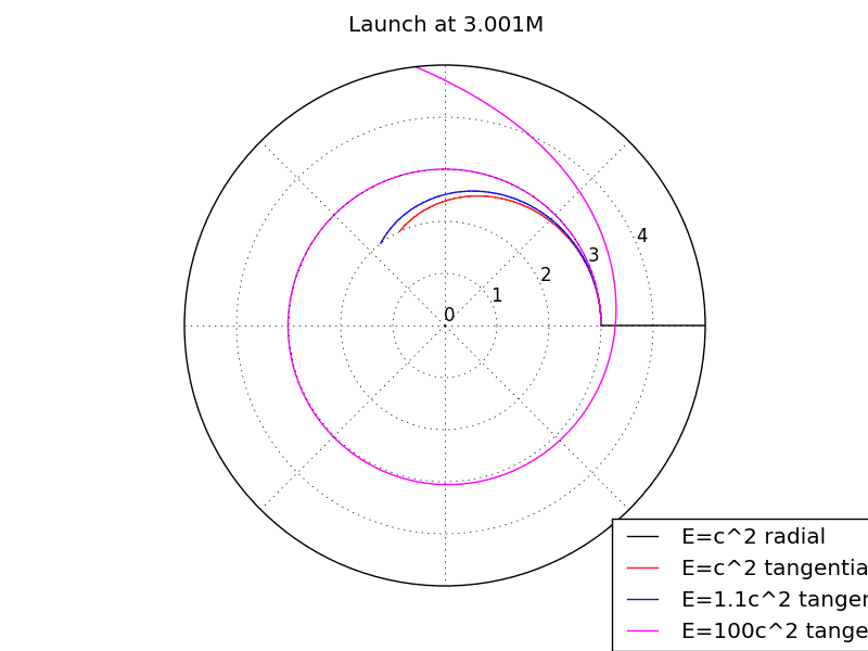

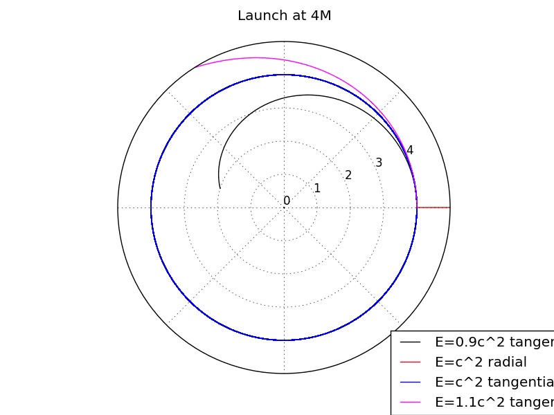

Ibix said:
tangential launches in the equatorial plane from 3M and 4M
I would try values in between. I agree ##3M## shouldn't be escapable, since it's the photon sphere; but ##3.001M## should be, although with a value of ##E## much larger than ##1##.
Also, what exactly does ##E## signify in your code? In the usual meaning of that symbol in the effective potential equation, a marginal escape trajectory (i.e., just coming to rest at infinity) should have ##E = 1##. But it looks like your ##E = 0.9## trajectory at ##r = 4M## escapes.
Here's a launch at 3.001M. E=100 does escape or, at least, passes 50M on a nearly-radial path:
It does escape (rightly or wrongly). Assuming I didn't muck anything up, I'm following Sean Carroll's GR notes chapter 7, equations 7.43, 7.44, 7.47 and 7.48 with ##\epsilon=c^2## (=1 in his notation) for a timelike path. What I've actually implemented is$$\begin{eqnarray}
\frac{dp}{d\tau}&=&-\frac{GM}{r^2}+\frac{L^2c^2}{r^3}-\frac{3GML^2}{r^4}\\
p&=&\frac{dr}{d\tau}\\
\frac{d\phi}{d\tau}&=&\frac{L}{cr^2}\\
\frac{dt}{d\tau}&=&\frac{E}{c^2-2GM/r}
\end{eqnarray}$$
For initial values you set E, the radial coordinate at launch, R, and the angle ##\psi##, which is what an observer hovering at R measures as the launch angle (0 is "straight up"). In this context L is a derived quantity:$$L=\frac{ER\sin\psi}{\sqrt{1-2GM/c^2R}}$$The initial value of ##p=dr/d\tau=\left(\cos\psi\right)\sqrt{1-2GM/c^2R}##. See also George Jones' and your comments in an old thread of mine on Schwarzschild null geodesics.

I'm slightly suspicious of my own results, I must say. For example, I agree ##E <1## shouldn't escape because as ##r\rightarrow\infty## ##E\rightarrow dt/d\tau##, which in the nearly flat spacetime far from the hole should be ##\gamma##. So an escape with ##E<1## implies ##\gamma <1##. But my E=0.9 trajectory looks like it escapes. I think I need to do some checking.
Edit: I've either messed something up, the integrator isn't appropriate, or the turnaround on that E=0.9 trajectory is much further from the hole than I guessed (aware I can actually check, not guess!)
What Peter said makes sense, so your program is probably correct. You can set ##\psi## to zero (i.e. radially or near it) and it should escape with E=1.

There was a bug - something to do with the way the energy and angular momentum were being set. I've modified the program to set them directly, rather than by specifying an energy and a launch angle. It's not quite so convenient, but it works. Here are launches at 4M, 3M, and 3.001M, which now behave as expected - it does look as if 3M-plus-a-tiny-bit is the closest free-fall approach. I'll have a play with zoom-and-whirl (if I can figure out the initial conditions!) but I can't see how it'll solve Steven's problem if you can't approach closer than 3M.

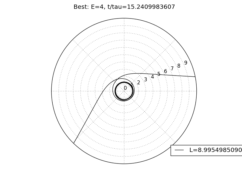

It's taken me a while to finish this, for a couple of reasons. First of all, I tried using a straightforward extension of what I was doing for Schwarzschild spacetime (taken from chapter 7 of Carroll's lecture notes), which is to use the conserved Killing quantities to generate equations for ##d\phi/d\tau## and ##dt/d\tau## and then the normalisation of the four-velocity to generate ##dr/d\tau##.
In principle, this works for Kerr spacetime. However, the more complicated metric and Killing equations yield a ratio of high-order polynomials for ##d^2r/d\tau^2##, which is a recipe for rounding-error induced disaster with a numerical integrator. But I remembered that @m4r35n357 had done this before, and his/her thread cited a paper by Kraniotis that does something clever with Hamiltonians to produce a much friendlier set of equations (equation 13 in that paper). Then the debugging took a while. :rolleyes:
I was going to attach a zip file, but apparently you can't do that any more. Instead I've just pasted in (in spoiler tags at the bottom) a Maxima batch file to do some algebraic manipulation of Kraniotis' maths (for interest, really), and a python script that uses the numerical integrator from the scipy library to generate orbits. It also uses matplotlib to display orbits in the Boyer-Lindquist ##r##-##\phi## plane, but that's optional (you'll need to comment out the import, the body of the plot function, and the final call to matplotlib.pyplot.show() if you don't have this library). The code can only handle orbits in the equatorial plane of a Kerr black hole, but extending it to handle out-of-plane orbits wouldn't be hard. The differential equations are defined in the __de() method, and the orbit() method calculates the values of the coefficients as well as initialisation and managing the integrator.
Since we were interested in the best time dilation, I wrote an optimisation function that accepts an energy-per-unit-mass (E) as an input and finds the minimum angular momentum that doesn't fall in. It calculates the elapsed coordinate time (at 50M) divided by the proper time along the path, which is pretty close to the time dilation factor (it ought to be calculated at infinity, but the integrator takes too long to get there :wink:).
Note that E, far from the black hole, can be interpreted as the Lorentz gamma factor relative to the hole (more precisely, relative to an observer hovering at constant Boyer-Lindquist coordinates in the ##r\rightarrow\infty## limit). Given that @stevendaryl was trying to avoid high delta-v engines, this has to be near 1. Unfortunately, that results in fairly modest time dilation factors. Using E=1 the two closest orbits (co- and counter-rotating) around an M=1, a=0.99 black hole give me 1.93 and 1.25 coordinate time at 50M versus the proper time along the path. You can do better by upping E. With E=4, you get ##t/\tau## 15.24 or 6.15 - obviously an improvement over the SR ##\gamma##=4, but it requires you to accelerate to around 0.97c. Here are some orbits, co-rotating with different initial energies:
So, unpowered doesn't work. I haven't tried any powered or semi-powered (e.g. "parabolic" infall kicked over to circular orbit then kicked back) orbits, but you could use this integrator to explore circular orbits and connect them to escaping orbits. Perhaps you could change orbits by ejecting a slug of some kind, rather than rocket exhaust, and pick it up again later to recover the braking energy?

Python:
KerrOrbits.py
Solves differential equations describing orbits of test particles (i.e.,
particles of negligible mass) in the equatorial plane of a Kerr (uncharged,
rotating) black hole using Boyer-Lindquist coordinates. Covers Schwarzschild
black holes in Schwarzschild coordinates if you set a=0.
Cannot handle orbits outside the equatorial plane.
Based on equation 13 in "Precise relativistic orbits in Kerr and
Kerr-(anti) de Sitter spacetimes", G V Kraniotis, arXiv:gr-qc/0405095v5
13 Oct 2004
Uses scipy.integrate to solve the equations and matplotlib.pyplot to
display paths.

def optimiseLaunch(st,E,Lcra,Lesc,froot):
    while True:
        Ltry=(Lesc+Lcra)/2
        RM=st.radiusM()
        orbitData=st.orbit(TIMELIKE,INWARD,E,Ltry,10*RM,15*RM,0.001,1000)
        if st.exitReason==ESCAPED:
            Lesc=Ltry
            ttau=orbitData[1][-1][-1]/orbitData[0][-1]
            print "Escaped - t/tau="+str(ttau)+" L="+str(Ltry)
        elif st.exitReason==CRASHED or st.exitReason==FAILED:
            Lcra=Ltry
            print "Crashed - L="+str(Ltry)
        else:
            print "Failed at L="+str(Ltry)+ \
                        "\nExit reason: "+TERMINATE_TYPES[st.exitReason]
            break
        if abs(Lesc-Lcra)<0.00000001:
            print "Found optimum - building plots"
            orbitData=st.orbit(TIMELIKE,INWARD,E,Lesc,50*RM,55*RM,0.001,1000)
            plot([orbitData+["#000000",1,"L="+str(Lesc)]], \
                "Best: E="+str(E)+", t/tau="+str(ttau),60,10,froot+"1.png")
                "Best: E="+str(E)+", t/tau="+str(ttau),10,1,froot+"2.png")
            break

st=KerrEquatorialSpacetime(1,0.99)
optimiseLaunches(KerrEquatorialSpacetime(1,0.99),4)
