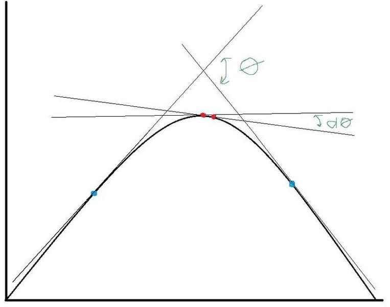

Here's my diagram:
The goal is to find the total angle ∅ between the tangent lines at the two blue points. I'm saying one way to do this is to start the two red points at the left blue point, and have them leap frog along the function until they reach the right blue point. Each time one red point leaps over the other, the angle d∅ between their tangent lines is found. If we add up all these d∅s from the left blue point to the right blue point, we should end up with the total angle ∅, right?
I realize that this is trivial because to find the angle between the tangent lines at the blue points one could simply place them end to end and measure the angle between them, but this is much more fun!
Let's say the end points are a and b. Let $$x_0=a, x_1=a+h, x_2=a+2h\cdots, x_n=a+nh=b$$ where $$h=\frac{b-a}{n}.$$ The angle as indicated in the diagram is $$\pi-\arctan(f'(x))-\arctan(f'(x+h)).$$ So you have to calculate$$\pi-\lim_{n\rightarrow\infty}\sum_{i=0}^n\bigg(\arctan(f'(x_i))+\arctan(f'(x_i+h))\bigg).$$
I think this is right but you can check numerically...
Cool! Three questions:
Can that be represented by an integral?
Will this work for any two points on any (continuous) function?
Must n go to infinity, or can it be any finite number and still get the right answer? If n = 1, isn't that the same as putting the tangent lines at A and B end to end?
1. Go here:
http://en.wikipedia.org/wiki/Riemann_integral
and look under: Riemann Sums. You'll see that you need a width. So I don't think you can write it as a Riemann Integral.
2. The slope can't be zero because the tangent line never intersects the x-axis and the concept of angle is meaningless. Therefore, try to avoid choosing critical points.
3. Yes if n=1, that's same as putting the tangent lines at a and b end to end. The following Mathematica code is useful for numerical results:

If arctan f'(x) represents the angle at point x (which it does), then the differential change of angle at point x is the derivative of that: f''(x)/(1+f'(x)^2). So you can integrate that across your interval to find the net change in angle.
If you are interested in the total change (as opposed to net change), then you want your differential change to always be positive, so simply put absolute value bars around the integrand.
