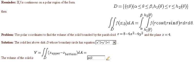

I found the equation of the boundary circle by setting z to 4 in the paraboloid.
Then I did some work to get polar coords:
[tex]x^2+y^2 = 1[/tex]
[tex]x^2+y^2 = r^2[/tex]
[tex]1-x^2-y^2 = 1-r^2[/tex]
Then I set up my integral as such
[tex]\int_0^{2\pi}\int_{0}^{1}(1-r^2)rdrd\theta[/tex]
After the double integration, I get pi/2.
edit: It should be 4r-4r3 as the integrand.
Why are you plugging 1-r2 in as the integrand? What are zupper and zlower?
Draw a sketch of the volume you're integrating. It'll help you visualize what goes where.
