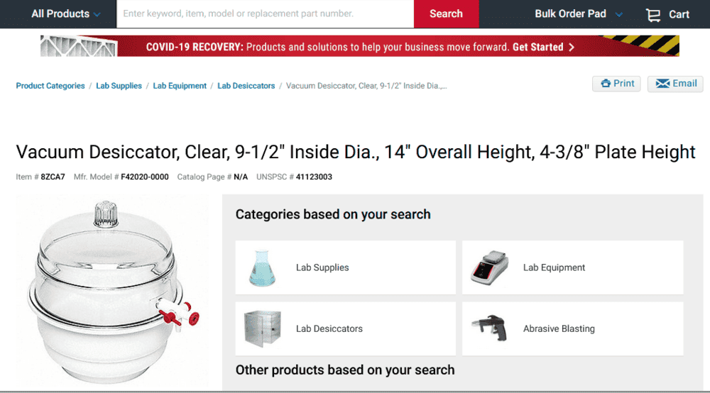

Please just buy one for your initial experiments. Here is a common one that should be safe and meet your initial needs:
https://www.zoro.com/sp-scienceware...KRe0p1huEpAireAcKayfnlVc-L7TWHDxoCE3sQAvD_BwE
And you didn't answer my question about what pump(s) you will be using, or what your application is...

Vacuum dessicators, IMHO, are an uneasy compromise between handling ease and robustness. Traditionally, they were made of glass-- thick, annealed, mating faces ground to plane, the tap port doubly or triply thickened against handling accidents. As glass will flex very slightly, the body had to be extra-thick for stiffness, with over-sized lips to tolerate handling chips and increase any leakage path lengths. A smidgeon of vac-grease, typically Apiezon (TM) or its kin, was the final touch...
Always, always, there was the worry that any tiny, un-noticed scuff or scratch might 'Go Large' and implode, scattering fragments like a broken 'Bottle TV' tube. Be NOT There !
The tough plastic versions are a lot safer in that respect, but much less tolerant of local heating...
DIY or not, consider adding 'safety mesh', a stronger, lab-grade sleeving than that used to 'sock' Christmas trees...
Slightly OT: When we dried or ashed lab samples, we generally cooled their crucibles in ordinary, non-vac glass dessicators, whose base held a dish of P2O5 dessicant or activated silica gel crystals. Before lid taps were routine, this usually meant leaving the lid slightly ajar. Snag was warmed air expands, and lids placed just-wrong could easily shift slightly, become totally clamped to base when that air cooled.
Samples could be re-tested with fresh material, but extricating crucibles without breaking them or the non-vac dessicator seemed impossible. Much bad language generally ensued, followed by a shout for me.
For a small-ish dessicator, I'd fasten an elastic band around the mating surfaces. Bigger dessicators had to be slanted. Pop into *ambient* vac-oven, pump down very, very gradually. When pressure difference sufficed, the dessicator's lid would hop. Either it landed sufficiently skew, or band would slip into gap and prevent re-sealing. Often, process left sample intact, too ! ;-) ;-) ;-)
