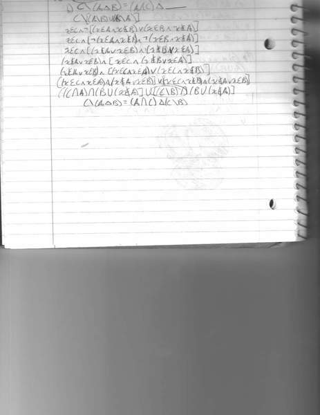

Alright so I was trying to solve this using logical equivalences:
Fill in the blanks to make true identities:
[itex]C \backslash ( A \Delta B) = (A \cap C) \Delta[/itex] ______
I made it to the end where I stated that the missing part was (C\B), but I'm not sure if my last step was justified
Equivalences 3. The Attempt at a Solution [\b]
I'll skip most of the steps (there were about 9) because I suck at latex but the last few are (working from the left side):
[itex][ ( x \in C \wedge x \in A) \wedge (x \notin A \vee x \in B) ] \vee [ (x \in C \wedge x \notin B) \wedge (x \notin A \vee x \in B) ] \\<br /> [ (C \cap A) \cap (B \cup (x \notin A) ] \cap [ (C \backslash B) \cap (B \cup (x \notin A) ] \\<br /> C \backslash (A \Delta B) = (A \cap C) \Delta (C \backslash B)[/itex]
So in the 2nd to last step, I dropped [tex](B \cup (x \notin A)[/tex] from both sides of the union because of the definition of symmetric difference which says that they would be dropped even if I left them in. Is this correctly justified?
Screw latex, here's a scan of my work
anyway, in the 2nd to last step I dropped (B union ...) out of both sides due to the fact that they would get dropped anyway when symmetric difference was thrown in, is this justified?

Okay so I rewrote [itex][ ( B \cup ( x \notin A ) ][/itex] because I realized that notation doesn't make any sense (which I originally knew but wasn't sure how to express the -xEA part in set notation) and came up with [itex][ B \cup ( C \backslash A ) ][/itex] which I believe is a way of representing that in this context (where the only values we are talking about are represented in sets A B and C)
Is this rewrite correct or is there some way of representing -xEA using set notation that I don't know about?
Anyway, after plugging that in I realized that the 2nd to last line reads:
[itex][ ( C \cap A ) \cap ( B \cup ( C \backslash A ) ] \cup [ ( C \backslash B ) \cap ( B \cup ( C \backslash A ) ][/itex]
And because of the first part which reads [itex][ ( C \cap A ) ][/itex], having [itex][ (C \cap A ) \cap ( C \backslash A ) ][/itex] is a contradiction, and because of that I can drop [itex]( C \backslash A )[/itex] from the equation on both sides.
Then, again because of the definition of symmetric difference (and because it's also a contradiction) I drop the [itex]\cap B[/itex] from both sides because it would be removed regardless.
Is this correct?
