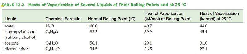

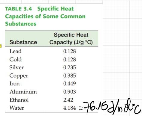

According to the Vaporization Heat table, the heat needed for 1 mol of H2O to evaporate at 100°C is 40.7KJ and 44.0KJ/mol is needed to evaporate H2O at 25°C. Thus 44.0-40.7=3.7KJ is the energy needed to heat H2O to 100°C from 25°C. However, according to the heat capacity of H2O, 3.7KJ will only warm the water by ~+48.6°C, which is not enough to reach 100°C starting from 25°C!

Nope, doesn't follow. To convert liquid water at 25°C to vapor at 100°C you have to either heat water and evaporate it, or evaporate water and heat the vapor - plus you will need to do work compressing the vapor, as saturated vapor pressure at 25°C is much lower than 1 atm that you will get at 100°C.

I'm still confused though; how water can be evaporated at 25°C then heated, Is it by lowering the pressure? And what the compression work is needed for?
Water evaporates at all temperatures, till the vapor gets saturated. Then you heat up the vapor - not much different from heating up air.
To convert water vapor saturated at 25 °C (about 3.17 kPa) to water vapor saturated at 100 °C (101 kPa) you need to both heat the vapor up and compress it.
