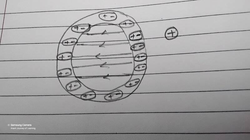

Yeah, I never thought about that point. But even if the shell isn't thin enough the E inside is non zero, right?
Sorry for the awful diagram.

I know I wasn't clear enough.As @Steve4Physics said, I meant polarization of atoms resulting in dipoles

Right. The induced field (at the centre of the non-onducting shell) is always non-zero. The shell thickness only affects the magnitude.
Note, your diagram shows the induced field to be uniform and to the left. But at each point in the hollow region, the induced field’s magnitude and direction depends on a number variables. The field has a more complex shape than a uniform field.
At the centre of the insulating shell, the induced field points in the same direction as the field from q; the total field at the centre (and probably elsewhere) is therefore larger than the external field from q alone.
Yes, that's true 👍
Thanks a lot @Steve4Physics! I got a lot of new insights!

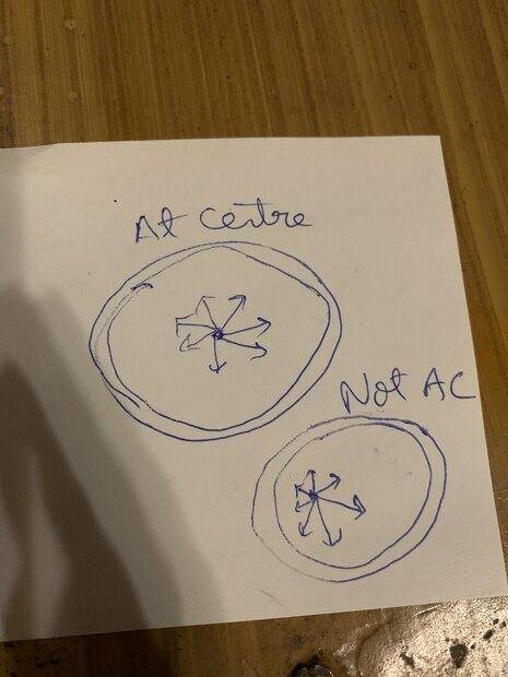

Steve4Physics said:
With no external charge present, the field is zero only at the centre. The field's magnitude inceases as you move radially outwards from the centre to the shell's inner surface (because of embedded charge Q).
You mean like this. At center it’s symmetrical and off center it’s not?

But based on my drawing don’t you think you are right? That field only at the center should be zero not everywhere whether it’s a conductor or nonconductor shell, thick or thin?
Your drawing refers to a completely different situation. You have put the point charge is inside the shell.
Also your field lines have different lengths. I don't know if that's intentional. Field lines are not vectors so different lengths have no meaning. (At any point on a field the electric field vector is a tangent to the field line.)

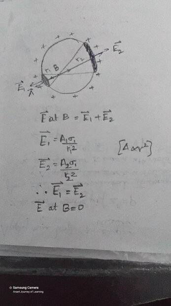

Its alright! It happened to me too :)There's a subtle argument regarding this:
Please refer to the image.
In a generic case, there would be a an angle between Area and r vector, but the cos theta would cancel from both sides.
For a thick shell, you could assemble many concentric thin shells within.
I didn’t put any charge inside. Just a point where I have shown the vectors. At center the field vectors will be equal . So field there should be zero. Off center vectors due to charge elements should be of unequal lengths and so a net field everywhere off center. But again that’s different from what gauss law tells(field is zero because flux is zero because no charge) .
Can you clarify?

I think if my previous post has a clue for you. The E caused by Area1 is Cancelled out by E of A2. For every area element, you can find another one. Therefore, E will be 0Edit: the diagram is for a conducting shell.
For a non conducting shell: Charge will also reside in the inner surface. That would result in flux lines inside, yet the E is zero. Please correct me if I am wrong
Oh I see! What you have drawn looks the same as field lines emanating from a point charge. And there was no accompanying explanation. Hence my misunderstanding.
Doing the maths, it turns out that the vector-sum of all field contributions at any internal point is zero. E.g. see @Shreya's Post #23. Interestingly, the 'zero field' is true for any shape hollow conductor (not just spherical) and is a consequence of the inverse square law.
