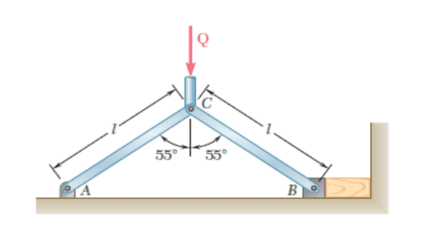

Member CB of the vise shown exerts on block B a force P directed along line CB. Knowing that P must have a (1237) N horizontal component, determine (a) the magnitude of the force P, (b) its vertical component

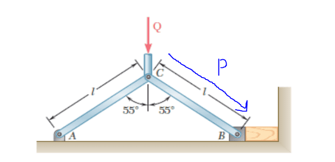

exactly that's my problem what the P force
Can you draw this?
kuruman said:
Can you draw this?
is it correct?

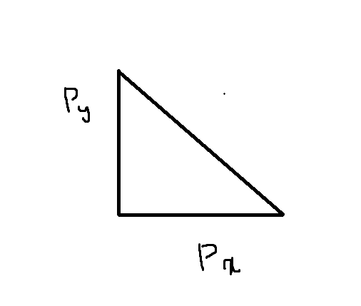

Can you draw a right triangle with P as the hypotenuse where the other two sides are vertical (label this one Py) and horizontal (label this one Px)?
Can you label the hypotenuse as P?

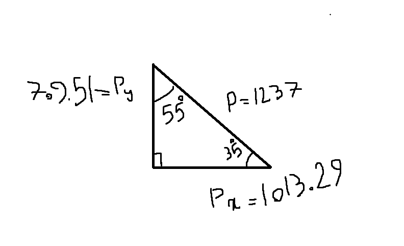

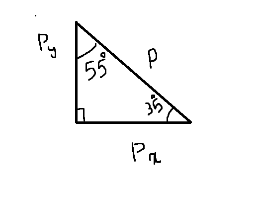

What are the three angles for this triangle? Can you fill in those measures on the drawing?
If you wanted to know the length of ##P_x## and you knew the length of the hypotenuse ##P##, can you think of a useful formula?
kuruman said:
Sorry sir but we don't have any length of p-x or p-y.
I find p-x=1013.29 and p-y=709.51
is it correct?
The given value of 1237 N is one of ##P_x##, ##P_y## or ##P##. Which one do you think it is?
Yes sorry sir i find out please check .

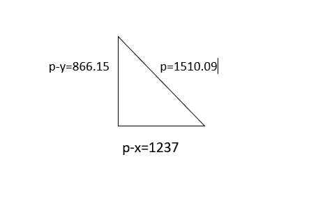

Below is a picture of the horizon. Which line do you think best describes the horizontal direction?
(A) From left to right.
(B) From top to bottom.
(C) From top left corner to bottom right corner.
obviously A
sHatDowN said:
obviously A
Obviously. Now look at my question in post #22 and your answer in post #23.
Yes Sir Sorry,I was on mistake.
OK, then fix your mistake and post the correct solution.
That looks correct.
