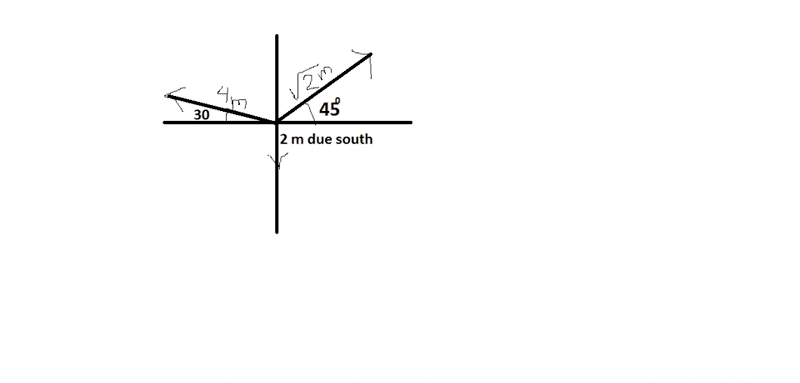

A particle undergoes three successive displacements given by ##S_1##=√2 m North- East, ##S_2##=2m due south and ##S_3##=4m 30 degree north of west , then find the magnitude of net displacement?
##S##= ##S_1## + ##S_2## + ##S_3##
I don't understand how to represent these displacement in the form of vectors.
I do have solution of this problem. According to the given solution
##S_1## = (√2 cos 45)i + (√2sin 45) j
I can't comprehend how the simple North-east turned into this equation? And I think the question not at all mentions angle 45 . Is there any convention or thumb rule that I am missing while dealing with directions?

Is this correct representation of the displacements in question?

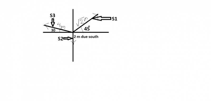

In solution ##S_3## is given to be (-4cos30)i +(4sin30)j
I did not understand why is there negative sign in (-4 cos30)i
Sign convention. Second quadrant has -ve x and +ve y. That way, S2 should be -2j.

Look at your diagram in post #4. Is the x-component of ##S_3## positive, negative, or zero?

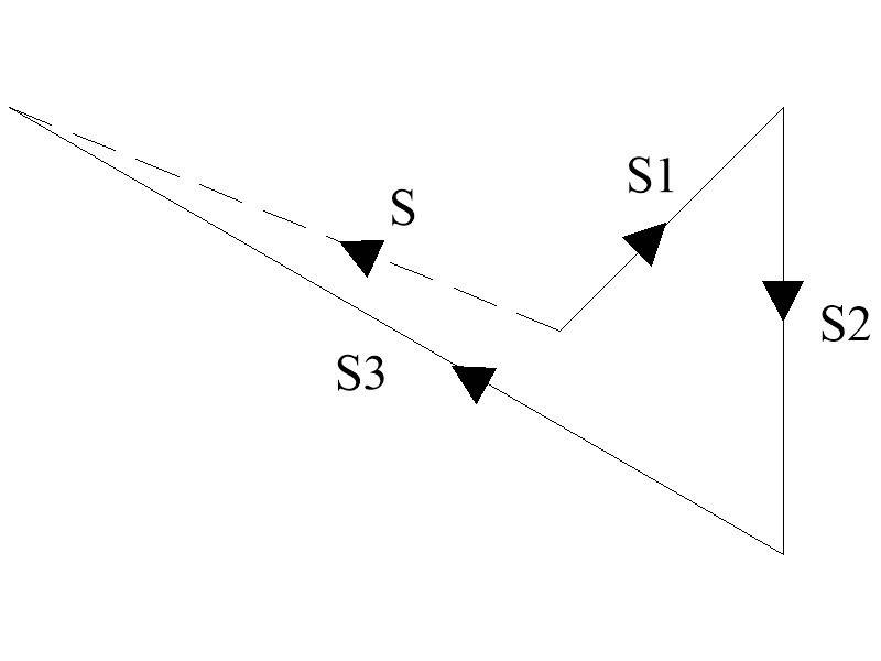

It may be helpful to draw the vectors to scale, and represent coordinate axes with a thin line, and the vectors with a thick line. (That way you can tell them apart.) Also, if you arrange the vectors head to tail, you will be able to get an approximate answer quickly.
Exactly, but in solution it's given to be +2j.
It should be -2j. There might be a typo in the solution provided by the book.

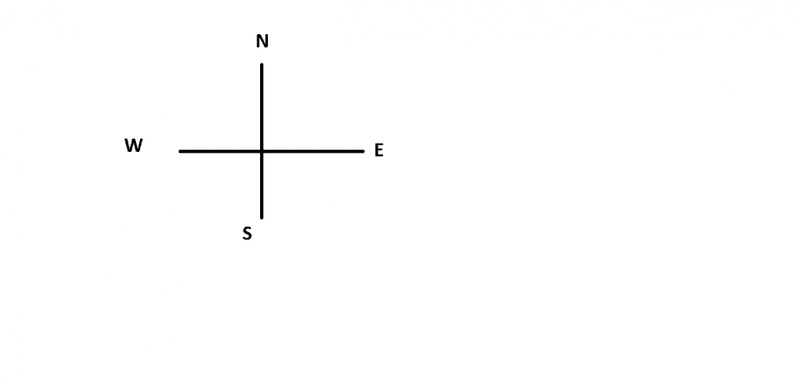

I encountered one more problem
Vector A points vertically upward and B points towards north.Vector product AXB is ?
a)along west
b)zero
c)vertically downward
d)along east
I've been drawing north as an upward direction .
Going with that approach angle between A and B would be zero
The wording implies north is not vertically upwards. Imagine you're standing on a ground. What does 'vertically upward' mean to you in this case?
Towards the sky?
So here shall I consider north in the usual way and vertically upward as coming out from page?
Yes.

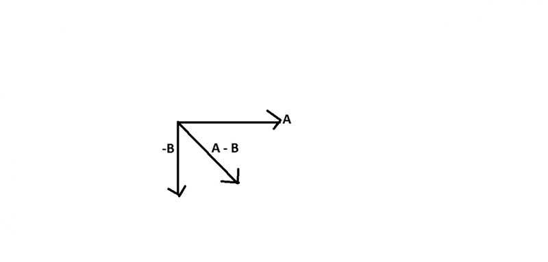

Vector A is pointing eastwards and vector B northwards then direction of (A - B) ?
1)North - east
2)vertically upward
3)vertically downward
4)None of the above
I tried to draw it
I think none of the above is the right option.
gracy said:
I don't think none of the above is the right option.
It is. Check you drawing. Have you drawn A-B correctly?
I have edited my post.
I think yes. What's wrong ?

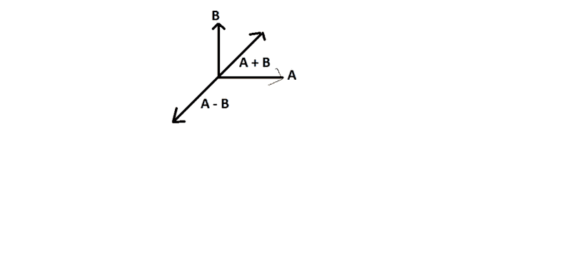

B is towards north. So what would be the direction of -B?
gracy said:
Oh! what I have shown as A - B is actually - (A + B)
Yes.
Direction of (A + B) is given to be northeast northeast means 45 clockwise from north . But the question does not mention magnitude of A and B is equal.. So why will their resultant be at 45 degrees?
