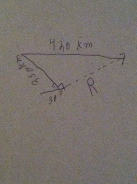

Here we are! I often find the diagram to be the hardest part of the problem, so critique to your heart's content! :)
This is not the diagram that I expected to see. I expected something like this:

The angle between North and NNW is 30 degrees and if you drew this to scale with 250km as 2.5 inches and 420km as 4.2 inches then you'd be able to measure the origin to dest distance and its resultant heading angle too.

ydist^2 + (420 - xdist)^2 = (final dist)^2
I don't understand how you get that equation from jedishfru's diagram (with which I presume you agree). How about we label some points: O = origin, A = point where course changes, B = point where we are due N of origin, C = final point. What right angled triangles do you have ?
I don't think the curvature of the Earth needs to be considered for this problem.
Do you see the right triangle with the hypotenuse of 250 km and one side is the north direction?
Its a 30/60/90 triangle and based on that you can compute the xdist and ydist:
sin(30) = xdist / 250 and cos(30) = ydist / 250
Do you now see where you went wrong?
Haruspex, this is where I got the equation. Did I misunderstand the reason he posted the ydist^2 + (420 - xdist)^2 = (final dist)^2 ?
I agree that we have a 30-60-90 triangle. I don't really understand why we divided the triangle into two triangles, but I think I see that the 250 km goes from the origin to the NNW point.
217^2+(420-125)^2=final^2WOAH! Is it 366 km? That seems about right. I forgot that I should calculate the vertical and horizontal components, and just assigned one distance to y and one to x.
You can check your result using graph paper and measuring out the distances using your diagram as a guide.
366km is what I got too.
You also need to find the heading using 366 and ydist as two sides of the second triangle between north and the final destination vector (the dotted line in my prior diagram).
Okay, so in this case I know the hypotenuse and the adjacent side, correct? So I should use the cosine function.
In that case, the heading would be about 36 degrees.
