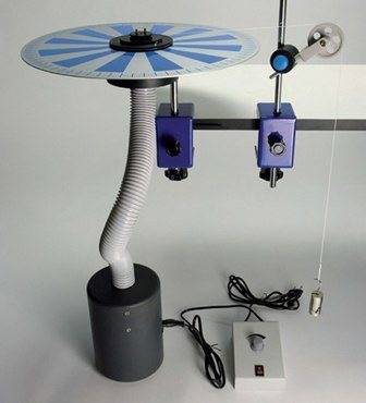

I have been playing with several vehicle dynamics simulators for a while now, and many of them require vehicle inertial properties to create realistic simulations.
There is very limited published data out there so I was wondering how could one calculate these properties experimentally? ...Other than hanging it on a huge pendulum or creating a big rotating table is there an easy way to estimate the principal moments of inertia of an actual size vehicle?
Any conceptual ideas would be helpful. Thanks JP

Make a model of the vehicle split into pieces where you can estimate the mass and CG position of each piece. Probably the most massive single "piece" would be the engine, which will have pretty much the same inertia properties as a block of material with uniform density.
You will have to "tweak" the complete model to get its total mass and CG in the correct position. Then work out the inertia from the components, using the parallel axis theorem etc.
That's the way it is done in "real life" at the design stage, though obviously it is easier if you are starting from a detailed CAD of the complete vehicle.
yes CAD and FEA is my plan B. But I was hoping that there would be an experimental way to find a solution ... Like those little intertia apparatus they have at the physics labs. An experiment along those lines I was hoping :)
Seems to me that a set of car scales could be used to find the various moments experimentally.
