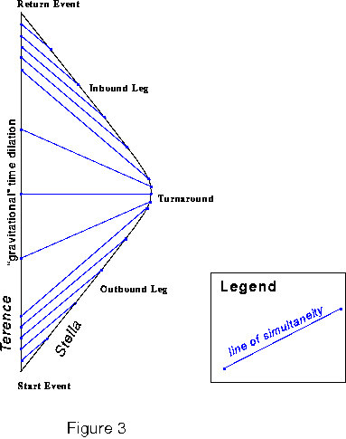

Drakkith said:
Of course, that is what I meant. Why does this happen?
It doesn't happen in any objective frame-independent sense, it just depends on what coordinate system the accelerating observer uses, different non-inertial coordinate systems have different opinions about simultaneity and thus different opinions about what clocks on Earth are doing "at the same time" that the traveler is accelerating. If you choose to use a non-inertial frame whose definition of simultaneity at each point on the traveler's worldline matches up with the definition in their instantaneous inertial rest frame at that point, then Earth clocks do move forward quickly during the acceleration, as seen in this diagram from the last section of the twin paradox page:
However, there is no rule that says the accelerating observer must use a non-inertial frame with this property.

Drakkith said:
I don't know what you just said here lol.
Well, which parts don't you understand? Do you know what an "inertial frame" is, and therefore what a "non-inertial" coordinate system would be? Do you understand the "relativity of simultaneity", that different coordinate systems disagree about which pairs of events are simultaneous? If not these are some of the most basic concepts of special relativity, I'd suggest reading some kind of basic intro to SR like the ones listed on this thread.
Drakkith said:
Do the people on Earth start to age quicker because events start to "catch up" to the spaceship as it deccelerates and then accelerates back towards earth?
No, the way a coordinate system defines simultaneity need not have anything to do with when the light from events reaches a given observer.
