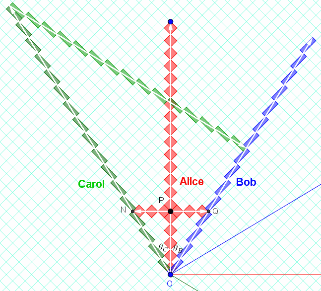

Here's a spacetime diagram on rotated graph paper to help visualize
why 15/17 is the relative velocity.
(This diagram is taken from my post on https://physics.stackexchange.com/questions/326272/applying-time-dilation-twice )
Alice measures Bob's velocity as 3/5, using the ratio PQ/OP "displacement/elapsed time according to Alice" ,
where OP is along Alice's worldline and PQ is simultaneous according to Alice (that is PQ is Minkowski-perpendicular to OP).
P is on Alice's worldine and Q is on Bob's worldline. PQ is "how far away Bob is according to Alice after elapsed time OP according to Alice".
Similarly, Alice measures Carol's velocity as -3/5.
Carol measures Bob' velocity as 15/17,
since after 17 "ticks" on Carol's wristwatch, Carol says Bob is 15 spaceticks ("sticks") away.
(This choice of 17 is out of convenience because the corresponding displacement is 15...
there are Pythagorean triples lurking when velocities like 3/5 are used.)
(btw, You can also read off the time-dilation factors 17/8 [relating Carol and Bob], and 5/4 [relating Carol and Alice, and relating Bob and Alice]. )The quantity NQ/OP (which you can form)
is NOT "the velocity of Bob according to Carol" since OP is not on Carol's worldline.
In addition, NQ is not Minkowski-perpendicular to ON on Carol's worldline.
