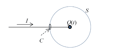

A current I flows along a wire toward a point charge, causing the charge to increase with time. Consider a spherical surface S centred at the charge, with a tiny hole where the wire is – see figure below. The circumference C of this hole is the boundary of the surface S. Verify that the integral form of Maxwell’s equation
$$\oint_{c} \vec B \cdot d \vec s = \int_{s}( \mu_{o} \vec J + \epsilon_{o} \mu_{o} \frac {\partial \vec E} {\partial t}) \cdot d \vec A $$
I attached a picture of the problem for clarification.

  • Diagram of a wire carrying current I from the left into a point charge Q(t) at the centre of a sphere S, with a small circular hole C where the wire pierces the sphere.

Wait a minute. Your figure shows that ##S## is the surface of the large sphere of radius ##R## minus the area of the small circle of circumference ##C##. That's fine. But if that's the case, what is the first integral on the right side, namely ## \int_{s} \mu_0 \vec J \cdot d \vec A~?## Isn't it zero because ##\vec J## is zero everywhere on the surface ##S## that you have chosen? Also, can you explain what ##\theta_1## and ##\theta_2## are?
Yeah I was confused about the surface as I didn't find the question clear on that. If that's the case then I'll have to go over the electric flux integral again. The angles ##\theta_{1}## and ##\theta_{2}## are between the axis of the wire and the vector from the wire pointing to any point on the circumference C. In this case I would get
