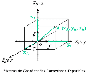

One proton experiences a force of $$1,10\cdot{10^{-13}}\;N$$ in the direction $$+y$$ due to a electric field
a) Calculate the direction and size of the electric field that causes the force
At a certain moment has a velocity of $$2\cdot{10^5}\;m/s$$
b) Calculate the magnetic field (size and direction) needed to apply so that the proton experienced a net force equal to zero
Data: $$q(p)=1,6\cdot{10^{-19}}\;C$$
$$\vec{E}=\dfrac{\vec{F_e}}{q}$$
Newton's second law
$$\vec{F_m}=q(\vec{v}\times{\vec{B}})$$
The attached file is the coordinate system I've used
a) $$\vec{E}=\dfrac{\vec{F_e}}{q}=\dfrac{1,10\cdot{10^{-13}}\hat{j}\;N}{1,6\cdot{10^{-19}}\;C}=6,88\cdot{10^5}\hat{j}\;N/C$$
b) $$\sum{\vec{F_{net}}}=\vec{0}=\vec{F_e}+\vec{F_m}$$
$$-6,88\cdot{10^5}\hat{j}\;N=q(\vec{v}\times{\vec{B}})=q\begin{vmatrix}\hat{i}&\hat{j}&\hat{k}\\v_x&v_y&v_z\\B_x&B_y&B_z\end{vmatrix}=q\left[(v_yB_z-v_zB_y)\hat{i}-(v_xB_z-v_zB_x)\hat{j}+(v_xB_y-v_yB_x)\hat{k}\right]=-qv_xB_z\hat{j}$$
The direction of $$\vec{B}$$ is $$+z$$
So $$\dfrac{6,88\cdot{10^5}\hat{j}\;N}{q\cdot{v_x}}\hat{k}=\vec{B}$$
$$2,15\times{10^{19}}\hat{k}T=\vec{B}$$
Have I done wright?
It looks like you have only listed the scalar speed, not the vector velocity with direction. Was the direction of the proton's motion given in the problem?
Check the units of E in your penultimate equation. You are off by ~##10^{19}##
Notice this balance holds only for a proton at a given speed (velocity actually @berkeman ) and the arrangement is very useful as a velocity selector for a charged particle beam (used in mass spectrometers often)

Hi everybody. berkeman, hutchphd, TSny:
berkeman, the velocity they provide is only the given in the statement
And this other?:
$$-F_e\hat{j}\;N=-q\cdot{v_\color{red}x}\cdot{B_z}\hat{j}\;N$$
$$-F_e=-q\cdot{v_\color{red}x}\cdot{B_z}$$
$$-F_y=-q\cdot{v_\color{red}x}\cdot{B_z}$$
$$B_z=\dfrac{F_y}{q\cdot{v_\color{red}x}}=3,44\;T$$
$$\vec{B}=3,44\;T\hat{k}$$
