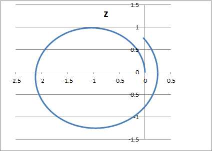

okay I ll share my code
Python:
#!/usr/bin/python
print("Lorentz Force Trajectory Calculator")
q=-1.6e-19
dt=0.0001
m=9.10938e-31
file=open("Dreams.txt","w")
Ex,Ey,Ez=(input("Enter the X,Y,Z components of the Electric field respectively in V/m: ")).split(",")
Bx,By,Bz=(input("Enter the X,Y,Z components of the Magnetic field in Tesla: ")).split(",")
E0=[Ex,Ey,By]
B0=[Bx,By,Bz]
E=[]
B=[]
for i in range(3):
    E.append(float(E0[i]))
    B.append(float(B0[i]))
Vi=[-dt/2,-dt/2,-dt/2]
Ri=[0,0,0]
P=[]
for n in range(1000):
    def cross(V,B):
        Px=(V[1]*B[2]-V[2]*B[1])
        Py=(V[2]*B[0]-V[0]*B[2])
        Pz=(V[0]*B[1]-V[1]*B[0])
        P=[Px,Py,Pz]
        return P
    y=cross(Vi,B)
    VHx=Vi[0]+(n-1/2)*dt*(E[0]-y[0])*(q/m)
    VHy=Vi[1]+(n-1/2)*dt*(E[1]-y[1])*(q/m)
    VHz=Vi[2]+(n-1/2)*dt*(E[2]-y[2])*(q/m)
    VH=[VHx,VHy,VHz]
    Rx=Ri[0]+n*dt*VH[0]
    Ry=Ri[1]+n*dt*VH[1]
    Rz=Ri[2]+n*dt*VH[2]
    file.write("%.3f %4.3f %4.3f\n" %(Rx,Ry,Rz))
    y=cross(VH,B)
file.close()
Well, I got what I asked for ... o0)
(still struggling to get pycharm debugging to work decently on my desktop )
But commenting is easy:
Why is the def cross inside the loop ?
Why is Vi = [-dt/2, -dt/2, -dt/2] ?
With 'VHx=Vi[0]+(n-1/2)*dt*(E[0]-y[0])*(q/m)' you take a huge step when n is large
I suppose you mean Vi[1]=Vi[0]+*dt*(E[0]-y[0])*(q/m) ?
Idem R. You want to integrate, i.e. R(t+dt) = R(t) + dt * dR/dt !
And I'd start with q=m=1, E=[1,0,0], B = [0,1,0], Vi = [0,0,1] and see what comes out (a straight line?).
Oh, and I see where your minus suign comes from. But now you use it twice for B
y=cross(Vi,B) has the same arguments with every call !
y=cross(VH,B) is overwritten bfre y is used

Actually, I think the only problem in my code is how to change the variables...for example at the end of the first loop we have VH vector right, so in the second loop this vector should be "crossed" by B.
Here what I am trying to do
So at first, it is like,
Python:
for n=0
y=cross(Vi,B)
    VH=[VHx,VHy,VHz]
then it should be like
Python:
for n=1
y=cross(VH,B)
    VH'x=VH[0]+(n-1/2)*dt*(E[0]-y[0])*(q/m)
    VH'y=VH1]+(n-1/2)*dt*(E[1]-y[1])*(q/m)
    VH'z=VH[2]+(n-1/2)*dt*(E[2]-y[2])*(q/m)
    VH'=[VH'x,VH'y,VH'z]
Python:
for n=2
y=cross(VH',B)
    VH''x=VH'[0]+(n-1/2)*dt*(E[0]-y[0])*(q/m)
    VH''y=VH'1]+(n-1/2)*dt*(E[1]-y[1])*(q/m)
    VH''z=VH'[2]+(n-1/2)*dt*(E[2]-y[2])*(q/m)
    VH''=[VHx'',VH''y,VH''z]

with q=m=1, dt=0.007, E=[0,0,0], B=[0, 1, 0], Vi=[0, 0.1, 1] I get a 'helix'
(picture is the x-z plane; y is boring)
Note: q=1 and m =1 and the other simple numbers make it a lot easier to check results.
