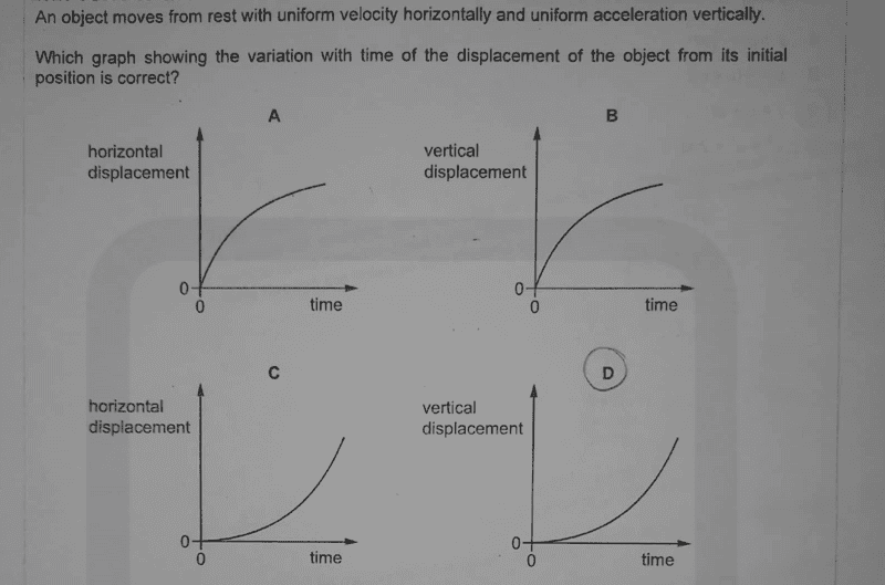

PeroK said:
That contradicts your second assertion that the object has no vertical velocity for ##t > 0##.
Where did I assert that? I asserted (or rather I repeated the statement in the question) that the object has no vertical velocity for t = 0.
  • #32
jbriggs444 said:
You cannot have it both ways. If being at rest at ##t=0## with a discontinuous change at ##t>0## is allowed for the horizontal velocity then surely the same can be true for the vertical velocity.
That would be the case if being at rest at ## t = 0 ## were the only condition, however there is another condition that vertical acceleration is constant, ruling out an initial discontinuity.

  • #33
In your argument to rule out graph B?
Anyway, that fact that three senior HH are criticising this problem is enough in itself.
This is my objection. That's an arbirrary interpretation of kinematic data. A linear graph for horizontal displacement does not represent an object initially at rest. A linear graph represents an object with an initial horizontal component of velocity.

  • #35
Are you referring to this:
pbuk said:
But you can't have a .... non-zero initial vertical component, and so B is not valid.
Here I talk about the initial velocity i.e. at ## t = 0 ##, not when ## t > 0 ##.
Not all HH in this thread share your view that the problem is "a mess".
But there is no linear graph!

Velocity cannot make a step change without going undefined. If you claim a step change at ##t=0##, you must abandon a claim about velocity at ##t=0##.
  • #37
haruspex said:
It is not clear what is meant by "moves from rest". That conflicts with "constant horizontal velocity" unless that is zero.
Okay. You've convinced me that I'm wrong. Moves from rest means starts moving from a state of rest. That's not possible if the horizontal velocity is constant.
The question is indeed incorrectly written. It could be fixed by stating that the object has zero horizontal acceleration. Then the question would probe what appears to have been intended.

Thank you @jbriggs444 for your considered analysis. As it happens I agree with you that
jbriggs444 said:
the wording is bad.
, however that does not mean that option B is a correct answer (and I don't think you are arguing that it is?)
But I do not agree with the rest of your analysis.

  • #41
pbuk said:
However that does not mean that answer B should be allowed as a valid answer to the question as it is worded, which is what you and @haruspex are arguing.
I'm not arguing that. Graph D is the only possibility. But, I don't like the question because there is no motion in the horizontal direction. It feels like something that has been cobbled together with too little thought.

my answer was D, which is correct considering the motion downwards eg, object thrown from a cliff
but what if an object is moving up?like a football being kicked?
i cant understand how this graph applies to that...
To kick a football, we will require an initial velocity in the vertical direction as well which is not the case here. In this case, the vertical displacement would occur according to y = 1/2at^2 which is an upward parabolic curve
