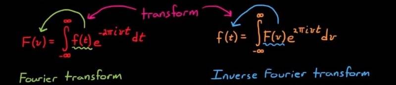

I searched online and found this video:
the first equation on the left transforms function of time into frequency but there is a - this time why so?
arent they meant to be the same
It's just the sign of f. The video definition is more sensible. Can you guess why I say that ?

I think the formula you were given in class is wrong. Even if it works it's completely at variance with every other transform pair I've ever encountered, and I've encountered many.
