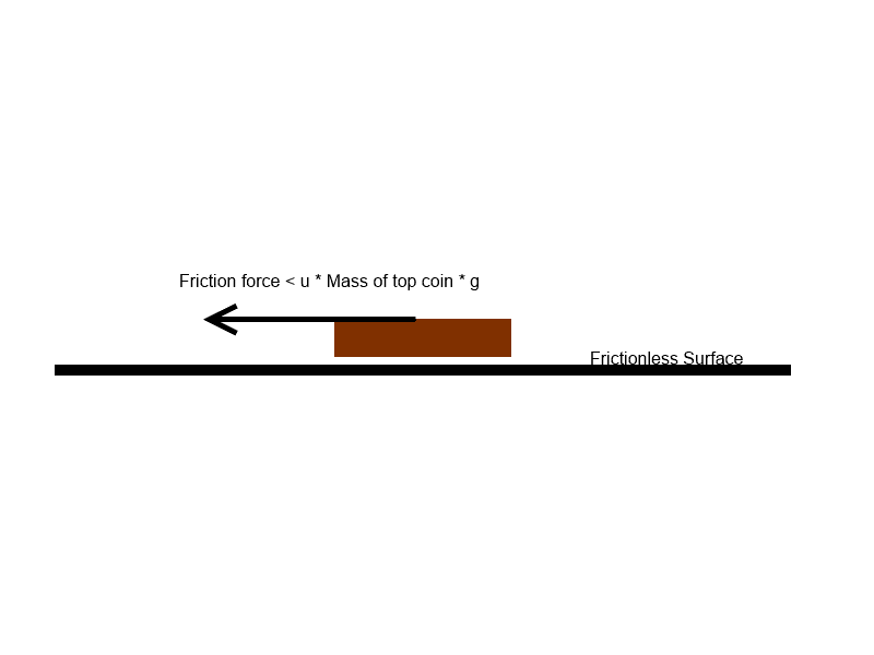

Suppose two rigid circular coins are lying on top of each other. A horizontal force on the top coin is applied. So, I think there are two possible scenarios:
1. Both move together with common acceleration (if friction between them is strong)
2. Only the top coin slips over the bottom (if friction between them is weak)
I can understand the second case that when force on the top one is greater that the max value of static friction between them, then the top moves over the bottom with a net force. But I can't understand how the first can happen.
If force on the top one is less than the max value of static friction, then friction between them applies an equal and opposite force to the top coin preventing it from moving. So, if force>max static friction, top slips over and if force<max static friction, net force on top becomes zero and no movement happens. Then, in what case exactly does they move together with common acceleration with friction acting as a connector?
Also, what if unequal horizontal forces are applied on both the coins? In what case will they both move together and in what case one slips over another?
Also, does friction act on the coin on which force is applied or does it act on the other one or does it act on both coins when one tends to move over other?
I need a brief understanding of the concept, please.

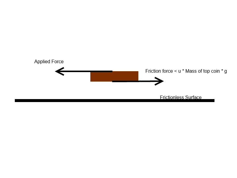

I still don't understand how can they move together if we apply Newton's laws. I am assuming both coins lie on an ideal frictionless surface on top of each other. So, if horizontal force on the first coin is smaller that the max possible value of static friction between them, then friction is capable of applying an equal and opposite force to the top coin and force on top becomes zero and no movement occurs.
if force on top>max possible static friction, then friction is not able to stop the first coin from moving and it accelerates with a net force=(applied force- kinetic friction) over the bottom coin and the bottom one stays motionless.
So, the case in which they both move as one object becomes impossible, but I know it is possible because friction can act as a connector. Think of when a box is lying on an accelerating car, the force acts on the car but the friction between car floor and box makes the box move together with it. But, I can't explain this by applying the laws.
I am assuming they lie of frictionless surface on top of each other.
Will someone please explain in brief intuitively instead of giving a short answer?

Only if the object doesn't accelerate. This is just Newtons 2nd law.
First step is to draw a free body diagram of the lower coin showing the horizontal forces acting on the coin..
The only horizontal force acting on the lower coin is transmitted to it by friction with the upper coin, let's call that friction force Ff. Don't worry about the size of that force because it turns out to be irrelevant to the question "does the lower coin move?". There are no other horizontal forces acting on the lower coin because you assumed it is resting on an ideal frictionless surface. So if there is any friction force between the two coins the net force on the lower coin is non-zero. Newton's laws say that means the lower coin must accelerate so there must be some movement of the lower coin.
Lets assume the coins have the same mass "m". Using Newtons law we can work out that the lower coin will accelerate at ...
alower = Ff/m
but since the max value of Ff is umg then the max possible acceleration of the lower coin is given by..
alower = umg/m = ug
You can take things further and work out if the lower coin will keep up with the top coin. For example if a very large force was applied to the top coin it might out accelerate the lower coin meaning it will eventually leave the lower coin behind.
To work out how the upper coin moves we draw a free body diagram for the upper coin...
The upper coin has two horizontal forces acting on it, the applied force call it Fa and the friction force with the lower coin Ff
So the net force acting on the top coin is Fa - Ff. Therefore it accelerates at
aupper = (Fa-Ff)*m
No we can look at the condition under which the coins accelerate together at the same rate...
alower = aupper
or
Ff/m = (Fa-Ff)*m
mass cancels
Ff = Fa-Ff
rearrange
Fa = 2*Ff
So for them to accelerate together the applied force must be no more than twice the friction force between the coins.
We already know that the maximum possible acceleration of the lower coin is μg so the maximum force that can be applied so the coins move/accelerate together at the same rate is given by
Fa = 2mμg

See my post #15. I showed how to work out what happens in your two coin set up using Free Body Diagrams and Newtons laws without any reference at all to the earth. There is no need to even think about reaction forces with the earth, no need for any approximations etc. You don't need to know how the applied force is produced (person, spring, rocket, magnet, gravity etc) as that's irrelevant to the two coin problem you described.
Prem1998 said:
I have read that the force of friction on an object always matches the applied force to prevent its motion until the applied force is less than max static friction.
That's correct if you change "less than" to "greater than".
The force of static friction between two objects matches the applied force until the applied force exceeds the maximum possible static friction force. The maximum possible static friction force is frequently defined as μsN where μs is the coefficient of static friction and N is the Normal force.
If the applied force exceeds the maximum possible static friction force then the objects slide relative to each other. Once sliding occurs the friction force is called the Kinetic friction force and is typically given by ukN where uk is the coefficient of kinetic friction.
