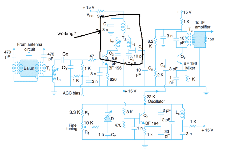

Hi friends,
I want to frame out how 75Ω impedance is matched by using tapped coil and two shunt capacitors connected in parallel. I think so for that I have to calculate the load value, and if we take the entire circuit out to be as a load then the most acute hurdle would to be to calculate the load value of the circuit.
I am completely messed up ..please help..??
Thanks
on Phys.org
The 75 ohms is matched by the tap low down on L1. The top of L1 is much higher impedance.
As shunting capacitors, the 10pF in series with 15pF will peak resonance of L1 in VHF band. They then form a capacitive voltage divider that applies RF to the base of Q1.
You should think of the 10 pF as the top of a Pi matching network, with L1 and the 15pF as the two legs. That network matches the high impedance of L1 to the base of Q1.

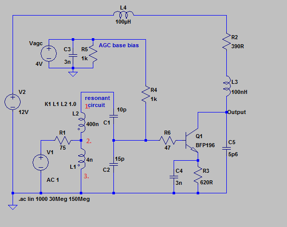

brainbaby. Here are a couple of files for LTspice to get you going.
Remove the .txt extension to run the simulation.

Hi Baluncore...
I have analysed your simulation files and it has been found very informative...but I want to find out the impedance at point 1,2 and 3...since the resultant graphs are in db/Hz...I want something to be in V/hz for voltages and amperes for currents...
The impedance at point 3 will be zero, at point 2 will be 75 ohm and at point 1 will be higher.
Here are two more LTspice files.
VHF_2 is improved model with cuttable link to see resonance.
VHF_3 is the resonant circuit only, with volts and amps.

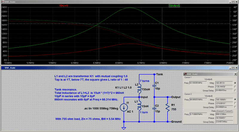

Thanks for the helpful reference to the source. I can see how you're not too satisfied with his explanation for this part of the circuit. (Though the earlier chapter on RF stages helps a bit in general terms.) I notice it is also in "TV and Video Engineering" by A.M.Dhake (P.236), so it must be a common circuit.
At least we know now what range of frequencies it might cover (band 1 and maybe band3) and possibly what bandwidth is required (probably a single channel at 7MHz.)
As I said, I'm no expert in this area, just a suck it and see, codge and bodge amateur, so my thoughts for what little they may be worth:
Since the 10pF and 15pF in series is equivalent to 6pF,
at 50MHz to 70MHz L1 needs to be about 1600nH to 850nH
at 175MHz to 240MHz L1 needs to be about 145nH to 73nH
So if we took around 60MHz and 1200nH, and we need about 7MHz bandwidth, then we need a Q of about 8.5, which means a parallel resistance of about 3700Ω. (And this resistance will not change at other frequencies.)
Now I'm probably more in the dark than you about the input impedance of Q1, but we know that there is a maximum about 1kΩ resistance in parallel with the tuned circuit due to the DC biasing circuit. So I don't think they can achieve that Q. Maybe the double tuned collector circuit provides the necessary bandwidth shaping and they just put up with intermodulation effects in the RF stage?
Anyhow, if I guess they are looking at an impedance of around 1kΩ at the tuned circuit, and step up the input to that level.
Tapping L1 at 2:8 would give 1:16 impedance ratio, matching the 75Ω input with around 63Ω, or 2:7 tap giving 82Ω. (Or looking at it the other way, stepping 75Ω up to 1200Ω or 920Ω.)
I'd have thought, your 4nH:400nH tap seems a bit high (though I'm not sure how you've calculated this.) I'd have thought, this would match the 75Ω into about 7500Ω. That would be great if the other side of the circuit could match it, but otherwise seems unnecessarily high. (Or again looking at it the other way, would transform a low Q circuit down to too low an impedance to be a good match for 75Ω.)
I'm not into Spice at all, so I'll await your results on this. I wonder whether you can simply drive the Q1 circuit directly, leaving L1 and the two capacitors out of the equation for now? From your point of view (wondering about impedance matching and tuned circuit tapping) it might be interesting to know the raw load, then see how attaching a tuned circuit and tapping in different ways affects it.
If you like Spice, maybe even forget this circuit and simply set up a tuned circuit with a resistive load and see how driving and loading it via taps affects things. It would take away any variation of Q1 input impedance which might obscure things.
Here is the tuned circuit, load 1k with BW = 4.5MHz.
Driven by a current of 1 amp, the input voltage is 75V, therefore Zin = 75 ohms.
Better approximates reality by lowering turns ratio of inductor. Now fixed the centre frequency, bandwidth, loading and input impedance.

I want to know what is the function of L2,L3,L4 and C2 and C3...?
The text says that is a double tuned mutual coupled via L4 network...but how can it be mutual coupled since L4 is not physically separated from the circuit in order to be mutually coupled...??
Special thanks to Baluncore and Merlin3189!

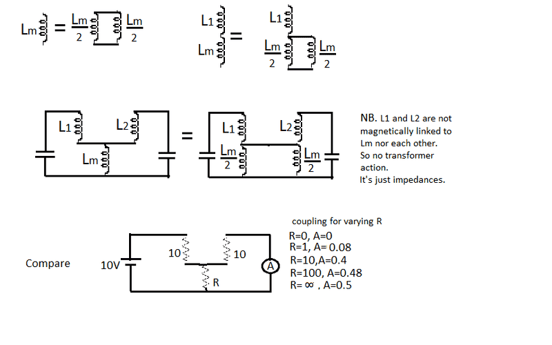

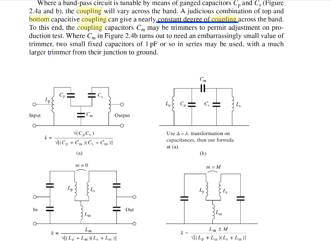

The coils are presumed to be spaced apart so there is no mutual inductive coupling between them.
Then we find that the currents in the two coils L2 and L3 both flow through L4, which provides "bottom coupling" by providing a common impedance.
The inductance L4 acts the same as the mutual inductance between two magnetically coupled coils. However, its inductance is added to both L2 and L3, which alters the resonant frequency.
Assuming L2=L3, then Coupling Coefficient is L4 / (L3+L4). Radio Engineers Handbook, Terman, p 164.
For critical coupling, kQ = 1. This give the flattest response.
Apart from the book which you have mentioned ...from where else I can get an elaborative explanation of common impedance matching...
This link provides all the information but is perhaps unnecessarily complicated for the present case.
http://frank.pocnet.net/other/RCA/Radiotron_Designers-Handbook_Fourth-Edition/09-Tuned-Circuits.pdf
I don't really agree with that
L2 and L3 are part of a transformer T2 and therefore are most likely to have inductive coupling
don't really agree with that either
It is standard practice to put inductors in the DC lines feeding a stage. L4 along with C1 decouple the DC rail from the RF signal that it feeds
This is to stop RF (AC) from going out ion the DC rail ... If allowed to, it would cause havoc as it caused oscillations on the DC railDave
Of course, we do not know if L2 and L3 have mutual inductive coupling, but from a design point of view it is undesirable. It would require close mechanical tolerances, or adjustment by moving the coils little-by-little. It is better to have shielded and isolated coils and use a known value of mutual coupling provided by L4. It is possible to use a combination of mutual and bottom end coupling, but there seems no point in doing this.
L4 is not used as a decoupling component. It is undesirable to use an inductor for this purpose here because of unwanted inductive coupling. Further, if it were used for decoupling purposes, the capacitor C4 would be placed at the bottom of L4, where its effect would be greater. The 390 Ohm resistor is a decoupling component.

May I take just one point to start with? You will notice that the current circulating in each of the two tuned circuits, L2-C2 and L3-C3, passes through L4. So how is it not introducing mutual coupling?
only if it were positioned to do so, otherwise it is just a RFC through which the DC is supplied as shown on my many examples
Well, I have watched as you have both put up good arguments in this debate. There is insufficient information on the schematic to be certain of the relative inductor positioning. In summary, on the balance of the evidence, I believe L4 is actually doing both jobs. It plays a critical part as an independent fixed inductor in the mutual coupling, but it is also cunningly installed to function as an RFC.
There is no question that the circuit is a double tuned, mutually coupled bandpass filter of unusual European design. It needs to provide a wide accurately controlled VHF passband while compensating for the BF196 transistor characteristics. The black art of RF design became a science during WW2, but it developed with a different style on either side of the Atlantic. The designer here was almost certainly not trained in the USA, so did not do it in the USA way. This schematic is from the European 'Pro-Electron' school. To me it appears to be in the Dutch style of Philips N.V. of Eindhoven.
The power supply isolation is primarily provided by C1=3nF, with the 390 ohm resistor to the +15V supply rail. The 390R plays no part in setting any stage bias current, it is only there for power supply isolation. C1 is almost certainly a large area ceramic disc capacitor selected for low impedance VHF characteristics. If C1 was any bigger, the price would increase and the VHF performance would suffer. So we can treat C1 as a reasonably good RF ground at VHF.
Although drawn in series, L2//C2 with L3//C3 make two parallel tuned circuits at VHF. But L2 and L3 are wound as T2, a well coupled pair of windings on an air core. At first this appears to be a contradiction; how can there be two independent tuned circuits while L2 and L3 are also a closely coupled transformer?
The explanation is that T2 is only a closely coupled transformer if the common terminal is solidly grounded. Without L4, T2 would remain as a two terminal network. Now we can see why L4 is being used. By introducing the controlled soft grounding of the common reference terminal through L4, the coupling coefficient across the circuit involving T2 can be very carefully controlled by component value. That makes a much more predictable VHF passband, with less need to adjust the coil positioning during manufacture. The difference current between L2 and L3 flows in L4. That difference current is effectively doing the mutual coupling.
You said that the L4 inductor is just a controlling device which controls the coupling and gives a better control on the EXTENT of the coupled signal…meanwhile I referred to couple of text and found that it also says the same thing that without L4 the coupling will vary at different frequencies of the pass band..and with the use of L4 the coupling will be constant..i.e constant coupling coefficient (k) with non varying response…
Can you rather justify it numerically……
I mean that we knew that the coupling coefficient of simple two inductor coupled circuit is k = M / √Lp.Ls and with mixed mutual bottom inductive coupling it is
k = Lm + M / √ (Lp + Lm)(Ls + Lm) ….so how can one assume that the value of Lm could force to make the value of k constant for any value of passband… ??
Please elaborate the regulative action of L4..??
You can model L2 and L3 as a transformer with a low coupling coefficient m.
You can model L4 as an auto-transformer, or two parallel windings, with a high coupling coefficient M = 1.0
Those two transformers share or blend the coupling in proportion to their impedance.
If I had the time I would model the circuit with Spice.
