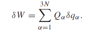

## \vec \tau = \Sigma \vec r_i \times \vec F_i ##
## \delta W = \Sigma F_i \delta x_i ##
Let's take our Cartesian coordinate system such that the axis of rotation becomes its z-axis.
Let's say that the body rotates through an angle ##\theta## so that the displacement ## \vec dx_i = \vec \theta \times \vec r_i ##.
Now, how to calculate virtual displacement?

This is one that is outside of my area of expertise, but I think you can use a generalized type of coordinate and then write it as ## dW=\tau \, d \theta ## where ## \tau ## is a torque. In more detail, as vectors, it may read ## dW=\vec{\tau} \cdot d \vec{\theta} ## , where ## \vec{\theta }## is along the axis of rotation.
Your equation ## \vec dx_i = \vec \theta \times \vec r_i ## is essentially what you need. Imagine the particles of the body undergo virtual displacements corresponding to a virtual rotation ##\delta \theta \, \hat \theta## of the body. What is the corresponding virtual displacement ##\vec {\delta r_i}## of the ##i##th particle?
Note that the virtual work can be written as ##\delta W = \displaystyle \sum_{n=1}^N \vec {F_i} \cdot \vec {\delta r_i} ##
In writing dxi = theta x ri you are equating a differential quantity with a finite quantity. This cannot be correct.
Instead, write dx = d(theta) x ri, where ri is constant for for each particle.
It is perhaps worth mentioning that the sum of the forces on a body or system can add to zero, and there can still be a net torque on the system. (For example, two forces of equal magnitude in opposite directions can both be applying a torque in the same direction). Thereby the system is then not at equilibrium, but can be undergoing a change in its angular momentum and rotational energy. The ## \delta W ## from any torques needs to be zero as well to have equilibrium.
