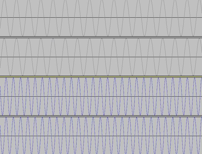

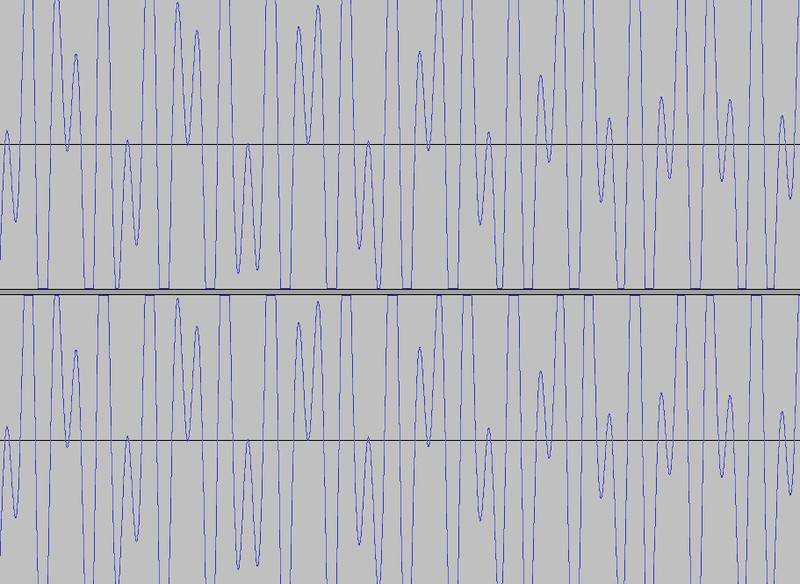

I thought I would give everyone an example. In the following diagram we have two stereo Wav files (LPCM). If we send a signal from any of these channels to the soundcard, we can produce a weak VLF wave at the same frequency.

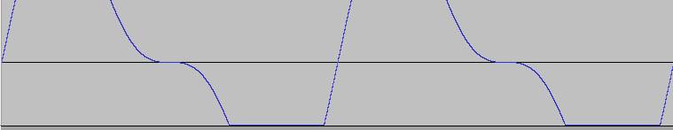

If we then mix the two Wav files, we get the output below. Rather than two waves superimposed, we have combination of the two waves.
The question is after passing this through the DAC of the soundcard, do we get an electrical signal that looks like the Wav file, or do we get the two frequencies as above?

At any point on the wire, there can only be one voltage at a time. So you can't get two waveforms independently. You will get a additive sum of the two.
This doesn't mean the carriers are lost and you could still recover each one with suitable filters. A suitable filter would be a radio receiver.
Note that this is not a mixer and you would not produce sums and differences of the two waveforms.

What happens in the case of a PCM? The following waveform is the product of combining a 2Hz, 1Hz and 1Hz sine waves. (ignore the clipping for now)
Each frequency would not be delivered separately to the cable. Does this matter? Will it still separate in the bandpass filter at the receiver?

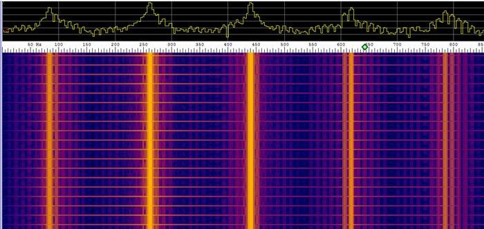

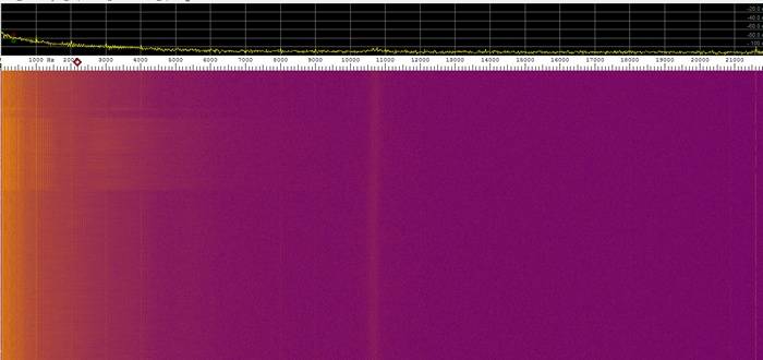

Sorry for the late reply, I've been caught up writing some DSP software for this project. I paid attention to both vk6kro and sophiecentaur in relation to harmonics and band pass filters and decided to run some tests.
My sound card provides an internal loopback that allows me to listen to the output without connecting a cable between the speaker output to the line in. This allows me to evaluate the signal quality without introducing noise or artifacts external to my machine.

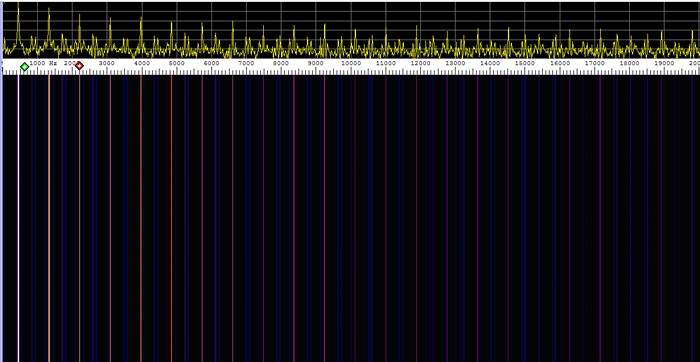

In this first diagram, I am playing a PCM at 440Hz. Without any sound, this spectrum would be entirely black. As we can see, the harmonics are extensive and propagate all the way up to 20Khz.

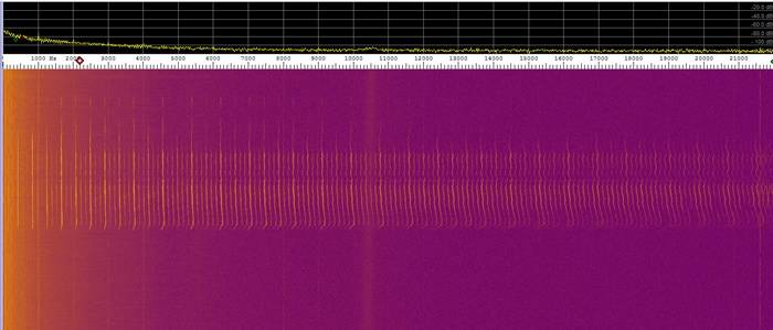

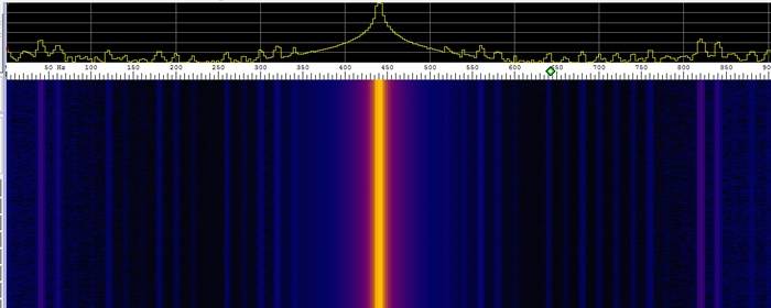

In this second diagram, we narrow in on our area of interest which is below 1Khz. We can see how the carrier wave at 440Hz is clearly defined and that the signal is well above the surrounding harmonics. What is clear is that sophiecentaur was correct and a band pass filter is required on the output stage. The source of the harmonics is the card's circuitry and internal crosstalk. If we look at the signal stability, we can see that the steep roll-off begins after 10-20 Hertz and a shallower roll-off of about 100-150Hz. This means that we can do FDM with about 25-30Hz separation from the main carrier frequency.

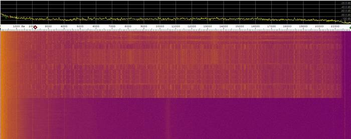

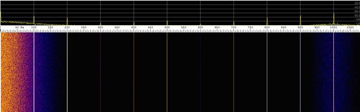

In this final diagram I test vk6kro's statement that due to the harmonics, the original frequencies would be unrecoverable. This signal is from a PCM that uses additive synthesis of two sine waves, 440Hz and 261.626Hz, which were each reduced by -6db to prevent clipping. As we can see, the harmonics are dreadful, but the two original carriers are clearly stronger by a detectable amount.
This analysis reveals that there are two ways to approach this problem. The easy route would be to ignore the harmonics and focus on selecting the strongest signals at the receiver. Its not a great solution, but it will work and more importantly will continue to function even if we change frequency. That said, we would need to inform the receiver of the number of frequencies to lock on to. In the case above, selecting the two strongest signals would achieve a link on our carriers of interest.
The second solution is a variable bandpass filter. This is a complex setup as it must function across the entire range of frequencies and be capable of controlled by computer. The upshot is that we can eliminate the harmonics and even narrow the bandwidth of the output signal. This provides more channels in our FDM setup.
Anyone got comments, good ideas, or schematics for a good variable band pass filter?

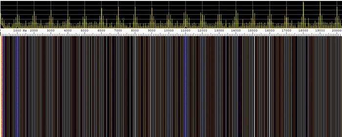

I wanted to check the harmonics from the additive synthesis of two signals at higher frequencies. For this test I increased the resolution of the spectrum analyzer to get a better picture of signal stability. This process is slower, but shows long term trends a lot better.

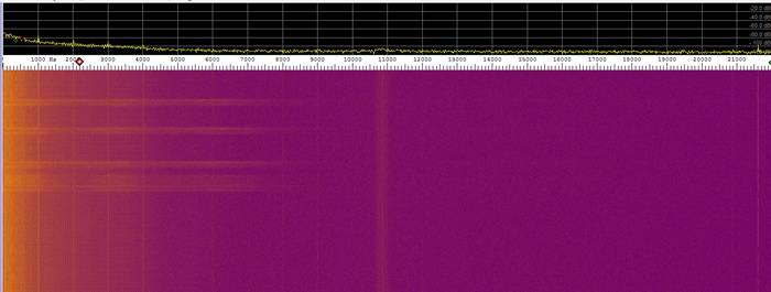

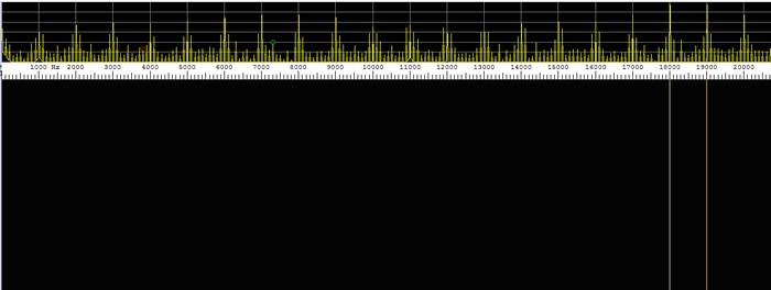

In the picture below, the signal is the product of an 18Khz and 19Khz signals. The harmonics are extensive but with digital filtering a threshold can be set allowing carriers to occupy frequencies occupied by weak harmonics. See the last image for more on this.

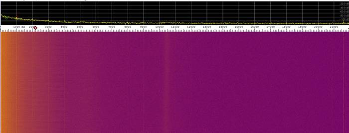

I also found some noise below 200Hz, around 1KHz and a similar noise pattern around 11Khz. Noise suppression under 200Hz is probably the result of filters rolling off. The noise at 1Khz and 11Khz is a little more difficult to explain and has no clear source.
Finally, the last diagram demonstrates the power of digital filtering. Achieving the picture below at a receiver with electronics would be both expensive and time consuming. Its a very complex design. In software, rejecting signals below a threshold is simple and you don't lose any power from the signal in the process. Using this threshold, it is possible to squelch weak signals on the same frequency (such as harmonics) and focus only on the main carrier of interest.
The harmonics of a data signal are much more than an inconvenience. They are there as a result of the shape of the original signal.
So, to reconstruct the shape of the original signal, you need to recover all the harmonics and make sure they are not mixed in with the harmonics of any other signal.
