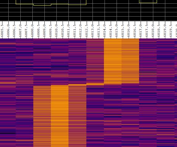

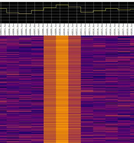

I have been focused on extending my visible bandwidth, lowering noise and removing mains hum for the last few days.
I figured out that the drivers with a sound card restrict the bandwidth to the audible range, up to 27Khz, before applying a high pass filter. By moving to ASIO to talk to the card directly on the line-in, rather than the microphone, I was able to get a visible bandwidth of 48Khz with a sampling rate of 96Ksps.
Applying a tracking filter I was able to strip most of the harmonics from the mains signals. That said, in doing so, I discovered secondary transmissions layered under the harmonics. Beginning at 150Hz, they are spaced around 300Hz apart. Given that I am running half a million samples through the FFT with a 96Ksps input, I am getting one pixel added to the spectrogram every six seconds. So, its difficult to tell if they are modulated, but distinct gaps are appearing so I assume so. I really need a good ADC and bandpass filters.
I am still running unamplified, but I am starting to see very weak signals emerge around 20Hz, 80Hz, etc. It looks like submarine comms. I'm also getting a lot of lightning strikes being detected. My noise floor is around -130dB at the minute, but that seems to be the card itself, as far as I can see I am dragging no noise in from the receiver whatsoever. This seems like a good approach, as I increase sensitivity I am able to eliminate noise as I go.

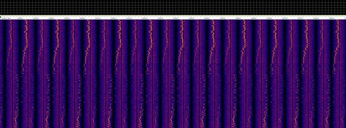

With respect to noise, have a look at the following diagram. This is around 26Khz, but I am seeing similar signals from around 1Khz. As I progress up the bands, I find random squiggles, but they appear to be confined to areas where the hum filter has reduced the dB. I think the automatic gain control is revealing them. As we approach the mid-20Khz, the signals start looking like the picture, rather than being confined to the edges of the purple bands that you can see (that's the hum filter).
Spectrogram with frequency axis in Hz from about 26480 to 26500 across the top, showing diagonal orange trace descending and vertical purple bands at regular intervals against a red background.
Any idea what these signals are?

You seem to be identifying a lot of low level signals. How can you be sure they are not just artifacts of your system? I should also like to know what equivalent receiver bandwidth you are measuring with. How long (processor time) does it take you to identify these very low level signals?
Also, it would be interesting to know how much wanted signal power will be turning up in this bandwidth. Have you done any actual coupling EM measurements yet? You can be sure of nothing until you have found the Signal Level so that you can then work out the SNR, which is the bottom line.

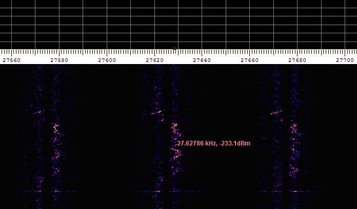

It looks like they are radiated and they are hidden behind harmonics to hide them. I applied a tracking filter to remove mains hum and another mains system at 25Hz (I have no idea where this came from) and applied adaptive gain. The signals you see in this picture below are around -230dB (yes, -230dB on a sound card at room temperature).
I have checked the Spectrum chart and this band is allocated to the military where I am.

Did a little testing today to see if the noise I was picking up yesterday was local. After much searching, I traced the source to a digital TV.
I've been able to reduce my noise floor further, its now at -245dBm. The interference from the TV, as can be seen in the picture below, is around -233.1dBm.
Waterfall spectrogram of a 27560 to 27700 kHz band with vertical noise streaks at several frequencies, with a cursor readout of 27.62786 kHz at -233.1 dBm.
