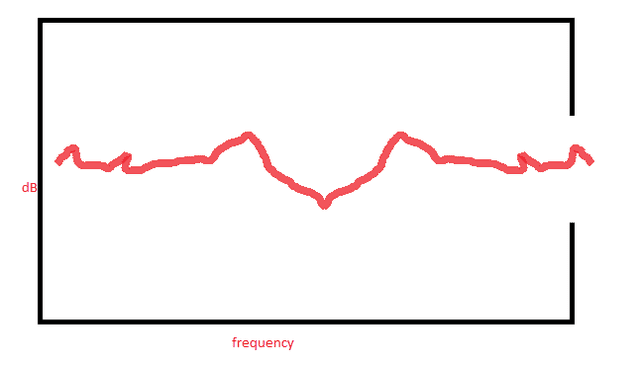

Hi, my high school astronomy class designs/builds antennas to detect VLF radio for solar flare detection. Recently, and regardless of their design, we get a strange "mirrored" shape to the dB vs frequency plot. The shape of the graph before roughly mid-band is exactly mirrored about the center.
The antennas are all small loop designs. We use an amplifier circuit provided from Stanford, and feed the signal into a soundcard (96kHz sampling rate). The computer is running linux and Stanford software (a python based program that does db vs frequency, and db vs time for selected frequency) and is usually rock solid. I don't remember changing anything about our monitoring station before this started happening.
Hoping some antenna gurus can provide some insight. Here is a rough sketch of what's happening...luckily this does not seem to be affecting the db vs time plot which is used to interpret flare occurrence. Something that also adds to the curiosity is that the frequency we are monitoring occurs on the axis of reflection.
WHat is the center frequency on the graph. If it is 48Khz then you are seeing aliasing. That's exactly what it would look like. You just expanded the X axis too much in your viewing program.
Do you need explanation of aliasing, and shannon's limit, etc?
Max on frequency is ~48kHz, the center is ~24kHz. Those are new terms to me, I can look it up though unless you have a moment.
Its true, I hadn't checked that before. The computer seems to be sampling at 192kHz, even though the project is designed for 96kHz. Should just be a matter of changing some linux settings I hope.

If you were really sampling at 192KHz, it would mirror around 96KHz
I think that if you apply a 10KHz tone to the sound card input you will see it reflected about the center of the output graph.
If you don't have a signal generator, the easiest way to get a test tone is with some free generator application on an iOS or Android device.
That will also serve to test and calibrate your display.
This afternoon I tried sending some signals to the sound card. You were right, they are getting reflected about the center. A 10kHz spike also shows at 38kHz, a 20kHz spike also shows at 28kHz, a 5kHz spike also shows at 43kHz, etc. These mirrored patterns are called aliases of my generated tone.

Thats why I was incorrect when I thought I was sampling at a higher frequency of 192kHz. Such a frequency is a sufficient solution to the Nyquist criterion for my bandlimit. A sample rate of 48kHz however is not...it doesn't satisfy the Nyquist criterion for bandlimits extending above 24kHz.
Therefore 48kHz must be my actual sample rate (that I need to change in software). What I am seeing as aliasing is the distortion of all signals above 24kHz...again predicted by the referenced theory.
The fact that the NAA signal of interest is 24kHz and that my data plot is reflected about 24kHz is just coincidence.
