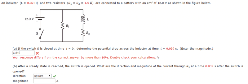

I posted the wrong problem picture.. So the two resistors aren't in parallel when the switch is closed? If YOU were doing this problem how would you start it?
The top of R1 is joined to the top of R2, but the bottom of R1 is not connected to the bottom of R2, (whether the switch is open or closed), so I'd say they are not in parallel.

I I re did my calculations and found I(t) for the circuit at time stated. I then used Kirchoffs loop rule for the outter loop : 12 V - R2*I(t) -L di/dt = 0
So 12 V - R2* I(t) = L di/dt = V(L) which gave me the correct answer of 9.8 Volt.

My method ignores R1, as none of the current through R1 passes through L and vice versa.
So I look at the series combination of L and R2 with a constant 12V applied across it from the battery.
First I note that at t=0 no current is flowing through L and R2 and the full battery voltage appears across L.
After a long time when the current through L is near enough constant, no voltage appears across L and the full 12V is across R2, giving us the maximum current in L and in R2 as 12V / 1.5 Ω = 8 A
So the voltage across L starts at 12V then falls exponentially to zero and the current through L starts at 0 rising exponentially to 8A.
The time constant for this is given as τ = L/R so for L and R2 in series, 0.32 H in series with 1.5Ω, τ=0.32/1.5 = 0.2133 seconds
Therefore the voltage across the inductor, which starts at 12V at t=0, is given by VL(t)= VL(0) exp(-t/τ) or 12exp (-t/0.2133)
So VL(0.039) = 12exp (-0.039/0.2133) = 12 exp(-0.1828125) = 12 x 0.83292 = 9.99509 V or 10 V to 2SF.
So the voltage across R2 (not asked for) is 12 - 9,99509 = 2.00491 V or 2V to 2SF (since whichever Kirchoff law may apply, the battery maintains 12V across the LR series combination.)
And then the current in both L and R2 being equal, it must be 2V/1.5Ω = 1.3A (calculator readout is 1.3366066)

For part b when the switch is opened, any current from the battery ceases and all current now flows in the series circuit of R1, L, R2.
There will obviously be a different time constant for the series circuit now, but the voltage and current will again vary exponentially with time.
