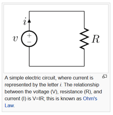

So what's the smplest illustration for voltage ,current and resistance and what's ohms law ?
The picture shows the simplest case when the material for the resistor R is ohmic. Ohmic means that the ratio V/I is constant.
