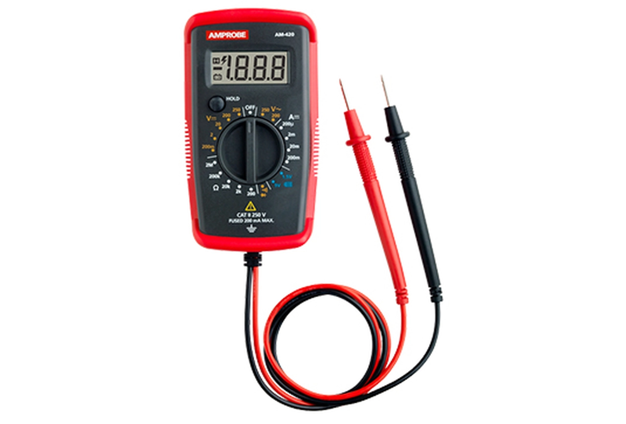

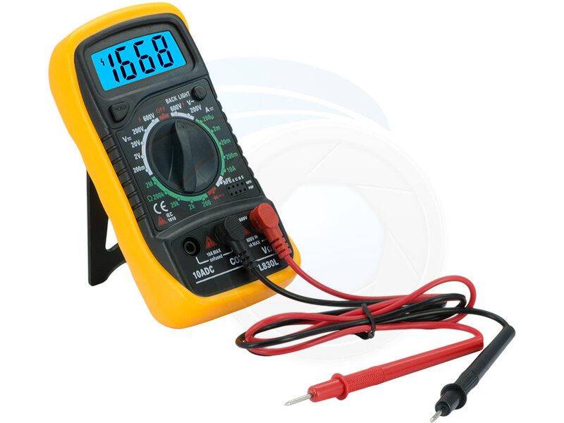

Yes. I didn't watch the video, but you've got the basic (and very important) concept. Voltage is ALWAYS a potential difference between two locations. This can be confusing because it is most convenient to keep one of those locations fixed. This fixed location is often called "ground" in electronics. Then, people get so used to always doing this that they just assume that you know that voltage is a measurement between two points, and that you already know, by the context, what that second reference point is. Then they (we) start talking about the voltage at a (single) point. This is just sloppy and wrong; but really, really common.
If you are ever confused about this, just remember what a voltmeter looks like; it has two leads. Always.

So when voltage is measured at a single point, the second point is omitted and considered to be ground.
