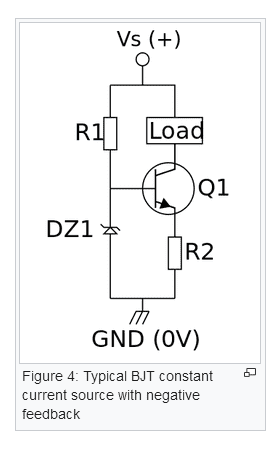

One key concept for current sources is their "voltage compliance range". That means that the output of a current source will only be accurate over some range of output voltages.
So for example, if you have a 12V power supply for your current source circuit, the output compliance voltage will likely be something like 0V to 10V. If you put a big enough current through a big enough resistor so that the output voltage climbs above 10V, then your output current will drop from the expected value (you are "out of voltage compliance").
You can see why this is true if you look at typical current source circuits, with a high-side PNP transistor as the main control element, for example. Or a low-side current sink NPN transistor for the control element as shown in the following figure:
https://en.wikipedia.org/wiki/Current_source

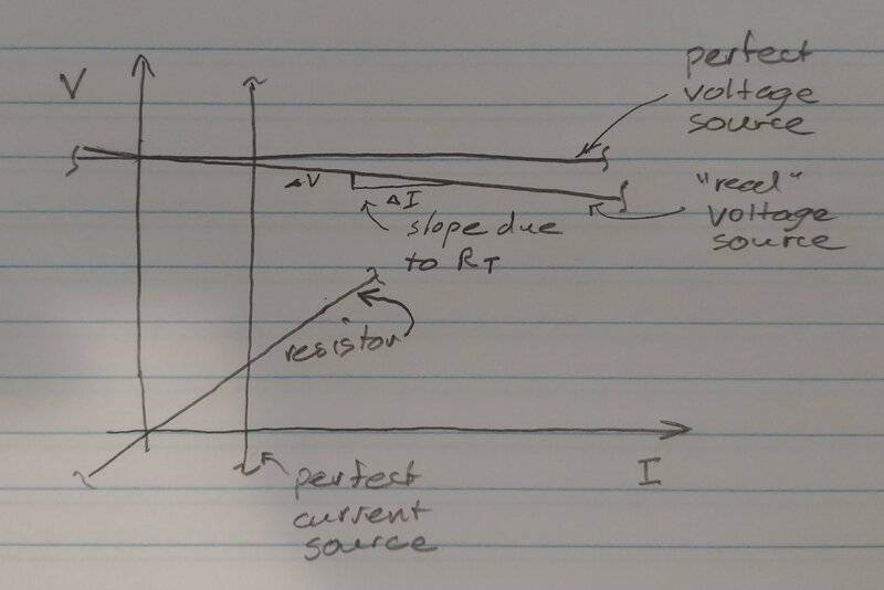

It may be helpful to look at a V vs. I plot of 2-terminal devices. This is for all possible DC conditions.

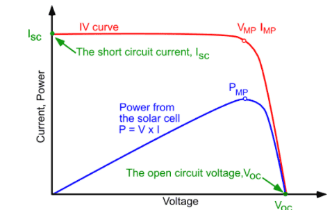

Or a real device that is both. A solar cell, like in a solar panel, acts like a current source for low voltages. I acts (almost) like a voltage source for low currents. So, depending on what your interest is, you can model a solar cell like an ideal constant current source or an ideal voltage source.
It is like saying that a line can be (almost) vertical and (almost) horizontal.
This is a perfect example of why you may want to use a simplistic model for rough a analysis. A designer working at the low voltage - high current region would want to substitute a current source in a 1st order model. But that won't work for the guy designing at the high voltage - low current region, they"'ll want to use a voltage source and series resistor. Either way, a simple model is a great first step, and is often all you really need.

For ideal resistors.
Not for ideal sources or their combination with internal resistance. That is why we model sources as a constant (ideal) source with a separate source impedance. This separation will be much easier for students to understand I think.
Finally, even for resistors, Ohm's law is an ideal simplistic model that we often choose to apply to real world components. It is just an abstract modelling choice, not unlike the ideal voltage source. Even resistors have a TCR or VCR which implies that, at some level, Ohm's law might not be the final word, but a pretty good approximation. There are many passive devices that don't follow Ohm's law (like incandescent lamps, thermistors, varistors, ...).

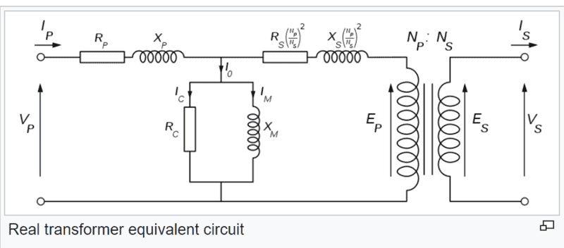

It sounds like in this thread we are mixing up the ideas of equivalent circuits and Ohms Law/Circuit Analysis tools. Below is the equivalent circuit for a transformer. Obviously, it is only an equivalent, not a depiction of the real thing.
I can make you an equivalent circuit of Canada. Would that trigger a discussion of Ohm's Law?
Yup, probably.
The ideal circuit elements used in network analysis are intentionally defined to be as simple as possible. Boringly simple, and not worth a lot of discussion. How you might choose to use them IRL is a different and infinitely complex subject with no simple answers.
