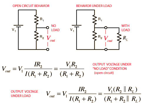

In voltage divider, how high must the resistance on Vout be so that voltage divider can be used according to convention? I'm looking for official references..

The value of the 'load' resistor needs to be added in parallel with the resistor across which you are measuring the Vout. The 'bottom resistor' of the pair in the divider has been modified. The answer to "how high" that resistor must be depends totally upon the accuracy that you require.
If the load is 100 times the resistance of the potential divider resistor then the error will be about 1% - because the effective resistance has been reduced by about 1%.

Two voltage divider circuit diagrams with V1, R1, R2 and Vout, one labelled open circuit behavior with no load and one labelled behavior under load with RL, with formulas for Vout below each.
The relative error will be as follows:
[itex]\Delta[/itex]V/V = [itex]\frac{|V_{out-load} - V_{out}|}{V_{out}}[/itex] = |[itex]\frac{R_{L}}{R_{L}+R_{1}||R_{2}}[/itex]-1|
I guess now you can figure out that to reduce the error all you need to do is either make RL very large relative to R1||R2 or make R1||R2 very small relative to RL.
If it's an open circuit-- how do u know there's no load? Open means that you don't know what's attached to it.
And if there's no load, doesn't it mean that the current won't bother to flow into R2 resistance? It'd much prefer to flow through the region where there is no load.
? Since when did current have any preferences? The expression 'No Load' means an Infinite Resistance so the voltage on the Potential Divider would not be affected.
How can "no load" mean infinite resistance? Load by definition means burdens, or something which weighs down on or oppresses! Saying no load means no resistors, not infinite resistance, IMO!
A load is useless if current does not flow through it and produce work. In infinite resistance no current flows through - thus "no load".

I believe that as a "rule of thumb" 2% error is considered negligible in engineering best practices (sometimes 5%).

It's electrical jargon - no load is generally accepted to mean unloaded, unburdened, unattached and unencumbered, as opposed to undefined...

Load can be expressed in terms of current, yes. Example, a load of 3 amps.
So "no load" is a load of zero amps. And only if the load is infinite ohms can you have zero current flowing while you supply voltage to it.

And as for "how much is an acceptable error?", the answer depends upon the application.
If you wanted to make a reference voltage for measuring some other voltage to within 0.1% (not very common but some people are into that sort of thing) then your 'load' would need to be at least 1000 times the value of the bottom resistor. For use in a domestic room thermostat, you would only be interested in a percent or so - so your precision would reflect this - a higher precision would cost too much in time and effort.
