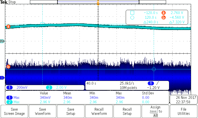

Here is the problem. When I measured the input AC voltage at the receiver antenna (Powercast) terminal, I got a very small signal with the maximum amplitude of 200 - 350mV. BUT I could get 2.6 VDC with full load as told above (MCU & sensor on full operation). Not all the times I could get this result, but sometimes I could. Please refer my picture below.
Probe1: Vin, RF
Probe 2: Vout
Please help me explain this phenomena. It seems my measurements went wrong, or my theory got sth wrong. Thank you very much.
I could not insert my image in the 1st post. Here is my result.
  • Oscilloscope screenshot of a Tektronix display in Stop mode: channel 2 trace in cyan near 2.96 V, a slowly varying line, and channel 1 trace in blue at 200 mV per division showing noisy fluctuation, with measurement readout Max 340 mV on channel 1 and 2.96 V on channel 2.

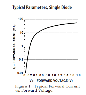

lbminh2015 said:
So say, if Vpeak is 300mV, the maximum voltage I will get is 1.2V, ignoring Vfwd and Vload.
Can you really ignore that ?
https://docs.broadcom.com/docs/AV02-1377EN
Log-scale graph titled Typical Parameters, Single Diode: forward current IF in mA on the vertical axis against forward voltage VF in V from 0 to 1.8 on the horizontal axis, showing a curve that rises steeply near 0.2 to 0.4 V and levels off near 50 mA.
  • Log-scale graph titled Typical Parameters, Single Diode: forward current IF in mA on the vertical axis against forward voltage VF in V from 0 to 1.8 on the horizontal axis, showing a curve that rises steeply near 0.2 to 0.4 V and levels off near 50 mA.
Looks like you are "getting something for nothing!":))

You will notice from Jim Hardy's post that the diode has high resistance for small voltages. For this reason, voltage multipliers do not give an advantage for small voltages. I think the lowest diode drop is from Germanium diodes.
To get the best energy from your antenna, you need to match the antenna to the high resistance of a single diode, which may be 1000 Ohms or more depending on signal voltage. It might be an advantage to choose an antenna with a high feedpoint impedance, such as a full wave dipole, or to use an impedance step-up device.
It is also possible to use diodes in parallel to reduce resistance.

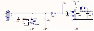

Dear all, thank you very much for your comments. I'm sorry not having mentioned the details of what I'm doing. I'm doing exactly an RFID transponder at 915 MHz. The reader I'm using has the output power of 650mW. At the distance of 15-20cm where I got the result as mentioned above, the received power, measured by a spectrum analyzer, is 3 dBm.
Please refer to my schematic is attached in this post.
@jim hardy : In practice obviously I could not ignore Vforward which is about 150 - 250mV (max) as noted in datasheet. What I wanted to say is that, even without any drop voltage at the diodes the maximum output voltage I can get must be less than 2.6V, which was the result I really got! So, WHY can it be like that?
@Tom.G : The carrier frequency is 915 MHz. The used oscilloscope has the bandwidth of 1 GHz and was set to full bandwidth for all 2 probes when measuring the signals.
- I do not have any resonant circuit; I have an impedance matching circuit (basic L-type) instead. However that circuit is not working. Currently I'm shorting the L simply by a small wire and leave the C open.
@tech99 : Yes I know the impedance matching is very important to harvest as most energy as possible. But I do not know how to implement that circuit in practice T_T The antenna I'm using is a microstrip one with S11 = -(15-20) dBm from Powercast. It's input impedance is around 50 Ohm.
For the parallel diodes, could you please tell me the multiplier's topology you were mentioning?
My question is still there. Even without any resonant circuit or impedance matching (or I really got it with just a wire?), the output voltage is much higher then it should be in theory. Thank you so much for your support and I hope I can explain my results with your help.
P/S: the transistor in my circuit is for data backscatter. I'm not using currently.

Unfortunately, the "Multiplier circuit.jpg" in post #6 doesn't say what the different traces are displaying.
A couple other points:
The scope is being used about at its 3db bandwidth, thus probably reading low.
Watch out for the capacitance of the transistor on the antenna feed, it could cause a serious mismatch.

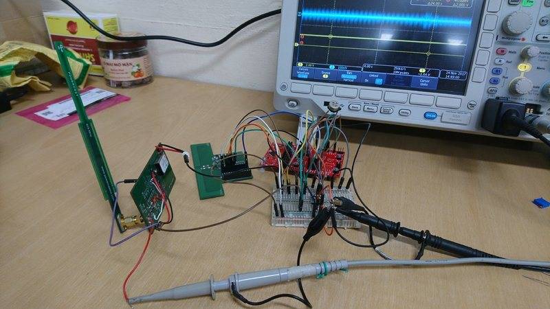

  • Photo of a breadboard prototype with a green RF antenna board, a red development board and jumper wires, with an oscilloscope screen showing a blue waveform and two scope probes connected.

Therefore I think you need to get the L-match working in order to obtain a voltage step up. Can you give the circuit? It must show resonance in order to work.
The antenna seems to be just one wire, as a probe, but you must have two wires to form a dipole. One wire on the end of a coax cable is not an antenna.
@tech99 : Thank you very much for your comment. Yes the matching circuit has been designed with a shunt C of 5.6pF and a series L of 16nH. But in practice, any time I soldered these elements to my circuit, the 2-stage multiplier could not boost the input voltage to the desired voltage. It got worse than it was without them!

Here are the possible inconsistencies I see:
  • In your above calculation the Diode Drop was not used.
  • It looks like there is an antenna standing vertically at the left of the photo and the "T" shaped board laying flat on the bench is another antenna. If that is the case you are transmitting vertical(horizontal) polarization and trying to receive horizontal(vertical) polarization. You will get much more power transfer if they are oriented the same.
  • About the power calculation. The spectrum analyzer most likely has a 50Ω input impedance to match the antenna and transmission line. Your receive circuit however will be close to open-circuit when it is fully charged. This will double the measured received voltage with respect to the spectrum analyzer measurement. (Perhaps the source of the factor-of-two over-voltage you were measuring?)
  • When the receiver is fully charged, you have a poorly matched transmission line from the antenna. The voltage at the end of that transmission line will depend on the SWR (Standing Wave Ratio) and on the phase of the standing wave at the end.
  • For accurate field measurements, which is essentially what you are doing, you usually need several feet clearance around transmitter and receiver to avoid reflections. SInce you are working very near-field, this clearance can be relaxed. (I don't have a good feel for just how 'relaxed' you can get away with.)
  • Many of the wire interconnects look to be a significant fraction of a wavelength long. They could well be interfering with the radiated field. Try to get them at least a few wavelengths away from the trans/rcvr. Oh, and the scope is close enough to be a reflector too.
  • The work surface does not appear to be metal but what is underneath it? Anything metal stored underneath there?
  • This one is probably not important, but just in case, what is in the wall around the workbench? From the photo it could be concrete, which is alright in itself. But around here (Southern California, USA), concrete walls have much steel reinforcement in them. This could have a small effect on your measurements.
I thought it is the forward voltage drop of the diodes which is 150mV, which was included in my calculation?
Yes you are right! The vertical one is for energy harvesting only and the T-shaped one is for backscattering with an SL900A RFID chip (although my future design will not have this chip).
