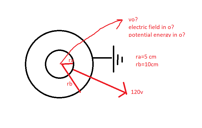

1. Homework Statement
the a shell is charged Va=120v
shell b is grounded, Vb=0V
What is the voltage in the center of shells (vo)?
The electric field in the center of shells?
The potential energy in the center of shells?
Vr=Va+(1/r-1/a)/(1/a-1/b)Vab (from integrals)
though I am not sure
I assume that V0=Va=120V but I don't think so
I assume the field inside is 0
1/ro=1/0=0(?)
Vab=120v?
vo=-120v?
Eo=0?
U=0?

You have not reproduced a proper problem statement. Please spell out the problem exactly as given and give your detailed attempt.
Sorry, my first time here. I have written more details.
Welcome to the PF. :smile:
Are the concentric shells spherical or cylindrical? Can you show the integral that is used to calculate the E-field for this geometry?
