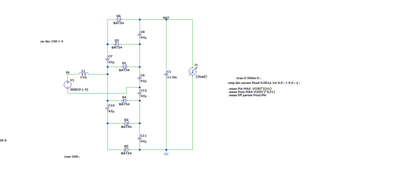

hello,
I did the simulation for the voltage multiplier in Vspace and I want to calculate the efficiency but the OUTPUT POWER is always negative. Do I need help?
can I calculate the power losses of this sextupler voltage multiplier or it is very complicate to calculate it ?

A low voltage input will be inefficient because each diode takes another voltage drop. There are other circuits for low voltage multipliers that use saturated transistors to increase efficiency.
Please attach your LTspice schematic.asc file as schematic.asc.txt so I can run it.
Hint: Use the LTspice "Tools" menu, "Copy bitmap to clipboard" to save a file.jpg that is compact and can be posted and read. Also, pack the circuit and text into a smaller area.

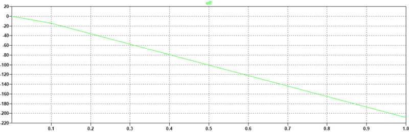

The 2.2 Mbyte file and the graph you provided are NOT useful.
If I had the schematic "filename.asc" I could generate the data here.

The output load is a current sink that overcomes the power input and pulls the output voltage negative. That current sink is delivering power to the circuit, the current is flowing through the six diodes in series. 6 diodes * 0.25 volts = -1.5 volts. Maybe use a 1k0 resistor as the load for initial testing.
The sine wave is only 1 volt at 4 Hz. That is insufficient to supply the output.
For LTspice, a 1 volt amplitude sinewave will peak at ±1.000 volt = 2.000 volt swing.
The three series diodes in each half are schottky, assume 0.25 volt each, x3 = 0.75 volt lost.
The coupling capacitors are 47 uF which is too small for the very low frequency of 4 Hz.
The reactance of a 47 uF capacitor at 4 Hz is; XL = 1/ ( 2⋅π⋅f⋅C ) = 850 ohm;
1 volt / 850 ohm = 1.18 mA, and that is only one of several capacitors in the series.
Why so low voltage and frequency? What is source?

Baluncore electromagnetic energy harvesting my input it produces 1 volt with 4 Hz fundamental
please how I can calculate the output power for this circuit?
The impedance of the output capacitor will be some multiple of the impedance of one of the 47 uF capacitors at 4 Hz. That's some multiple of about 850 ohms. Probably about 10 times, so something like 8.5k.
A short circuit of the fully charged C1 would deliver considerable power but only for a short time. Other than that at about three volts through about 8.5k. Call it maybe 0.3 milliamperes continuous
There cannot be more power out than in.
What current can the source supply?
What is the source? and how much power is available?

2.5 mA And the maximum power available 110µW the source electromagnetic
1 volt * 2.5 mA = 2.5 mW.
Since 110µW input is less than 2.5 mW, either the 1 volt or the 2.5 mA is an overestimate.
That small amount of energy is not worth harvesting.

cheniour oussama said:
... sorry I have no right to provide the exact informations about the electromagnetic maybe you don t believe that there is EM with 4 HZ but it exists ...
L1, 30 uH is too small to have any effect at 4 Hz. Is L1 supposed to extend the conduction angle of the diodes, or does L1 represent a 30 uH pickup inductance?
If it is the pickup coil, then increase the inductance by a factor of 6² = 36, and you will have your voltage multiplication by 6 times.
Summary:: how result efficiency problem
hello,

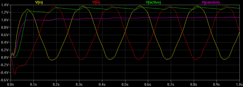

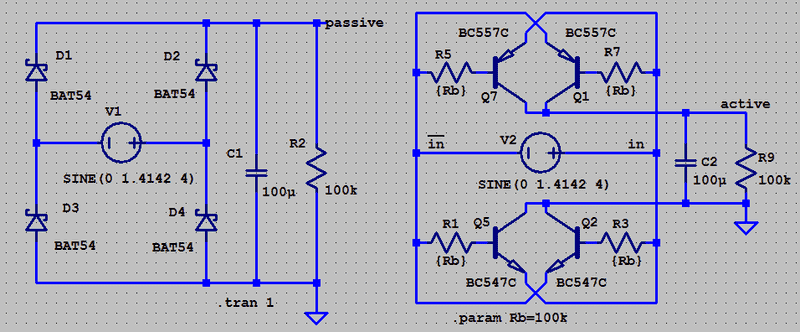

I m trying with mA I don t understand why the efficiency always a very week, however, the voltage multiplier use passive components so there is not a lot of losses and Schottky diode have low forward bout 0.25v
The Schottky diode has greater losses than an active switch using a saturated BJT in place of the diodes.
Here is an example of a bridge rectifier. The passive circuit (magenta) produces a lower voltage than the active circuit (green).
